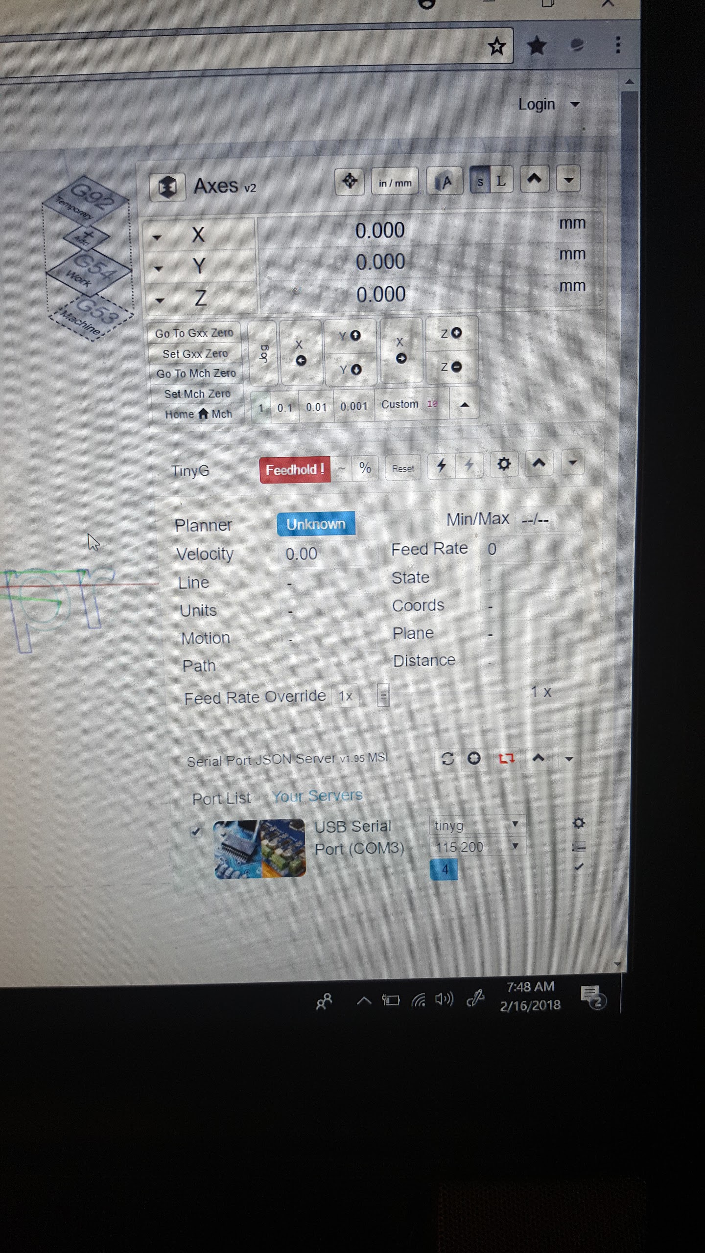

Any help, Just plugged in the OX for the first time and I am getting an error 9 and unable to do anything, Any advice?
Using tinyG and Chillipeppr
Use http://chilipeppr.com/tinyg workspace, connect motor power to TinyG not only USB, choose tinyg in spjs and you should be good to go.
You may temporarily disable alarms on the first run, just be cautious and don’t move beyond axis limits or into the bed.
http://Chilipeppr.com/
@sszafran How would i go about disabling the alarms, I have the above done on the tinyg workspace but i am still getting the message above. Thanks for the help
It looks like you have a Grbl controller in that screenshot, not a TinyG.
I don’t use OX and I don’t know what controller is there, but following John’s advice, possibly go to http://chilipeppr.com/grbl workspace and try there.
Once you connect you should be able to type $$ from the console and see all parameters. For configuration details please go to https://gitgub.com/grbl/grbl for old versions or https://gitgub.com/gnea/grbl for Grbl v. 1.1.
Perhaps you didn’t home it first?
