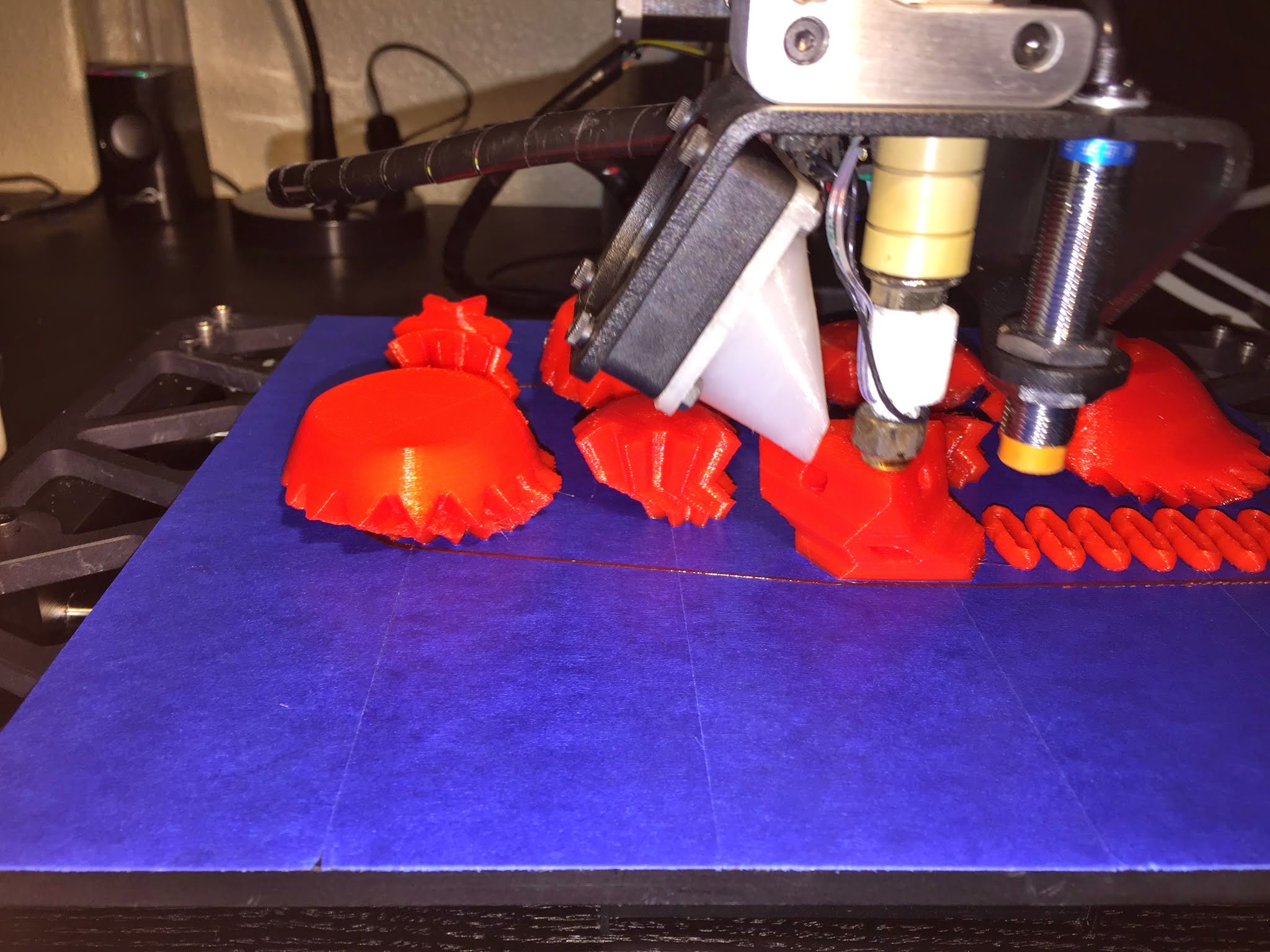

Any idea why I can’t print this Three Heart Gears project. This was the first time I tried printing it. That item under the extruder has shifted way to the left along with the rest of the print job. I tried printing this again but it did the same thing, but not as bad.
Check the belts, if it is slipping,
Also check the endstop if is bumped during print
did the head/fan hook on something as it was printing?
belt tensions are not enough, as already commented above…
aslo pulleys might slipping…
I tightened up the Y axis belt some. The X axis is good to go already.
I have noticed that I may not have my bed dimensions setup correctly. It does grind the belt when it does the perimeter. Not sure if this is a setting under my slicer or on Repetier Host. It mainly prints to the right, but it always fits in the box when I slice it?
maybe a short between the z and x/y motors? could be caused by a bent cable, because it’s just in a certain area

Looking at this. The last line X25.00 does that mean it will start the print job 25mm over to the right? Just trying to figure out why the belt grinds on large prints, even thought it fits in the box…

The reason prints get offset on Printrbots is because the first probe location is only 10mm from the edge of the bed, and the end stop prevents it from probing the spot, offsetting the print head 15 on the x-axis. The easiest way to fix this is by setting the X-offset to 10 mm instead of 25mm (M212 X10) this should solve the shifting print issue, but slightly screw up Z-offset
Source: Simple Metal owner
@Ishaan_Gov That is exactly what I needed. Thanks!!!
Just now starting to print this. It didn’t grind the belt this time. Guess we will see what happens in the next 17 hours.
Looking good so far. That must have been my problem. At least now, I’m using my entire print bed.
