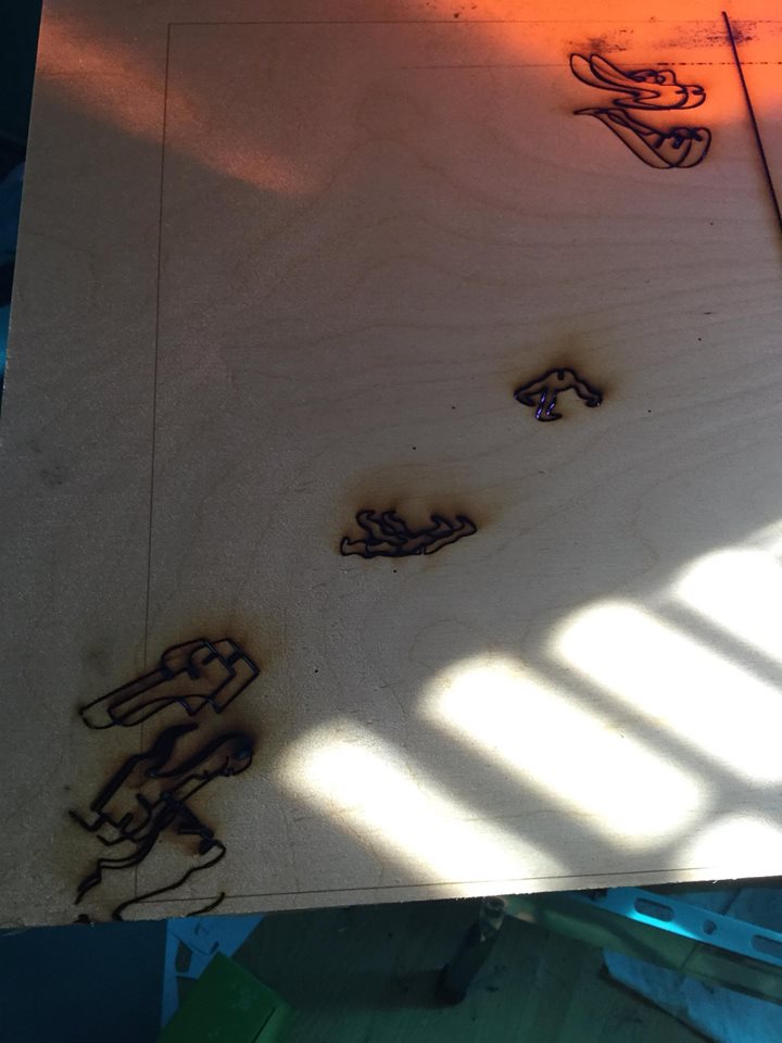

any ideas what is going on here? you can see the workspace trace..
any ideas what is going on here? you can see the workspace trace… then the cut travels outside the work area, and then the cuts are on top of eachother…
Can you give a little more background? E.G. New machine? Stock setup and software?

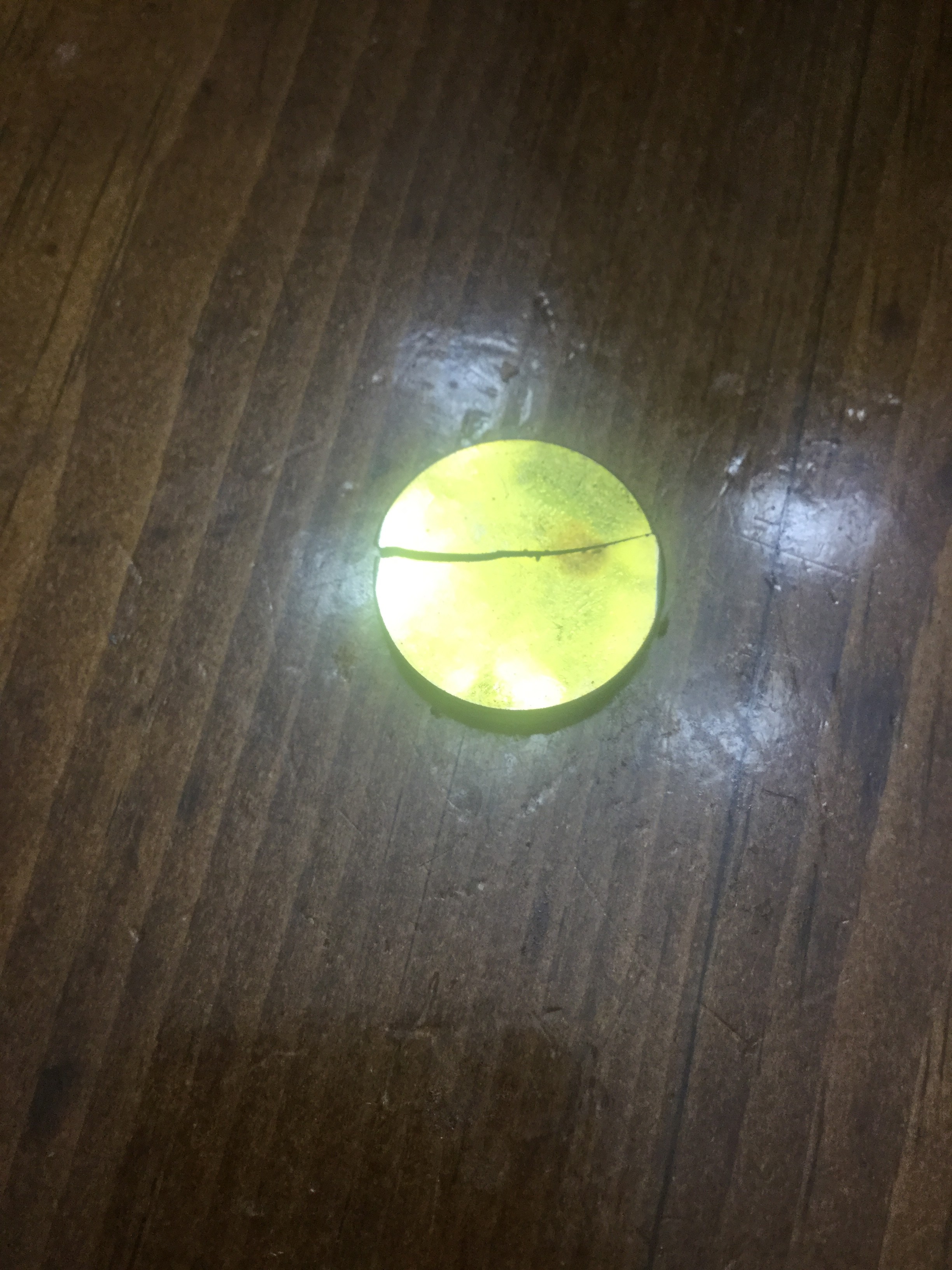

@Nedman had to widen the air assist outlet as i had ring reflection compounded by a split mirror
Ah yes it definitely looks like you found the problem. Sucks about the mirror though.
