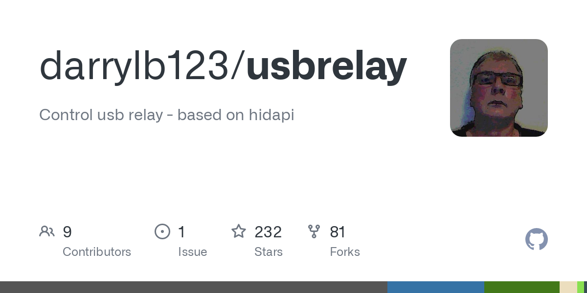

Maybe this will work as a few things I found while searching mentioned a similar protocol for these USB controlled relay boards. The pictured board looks like the one you are using and there is a Python extension( python3 required ):
Many thanks, Doug.
It works with my relais!
