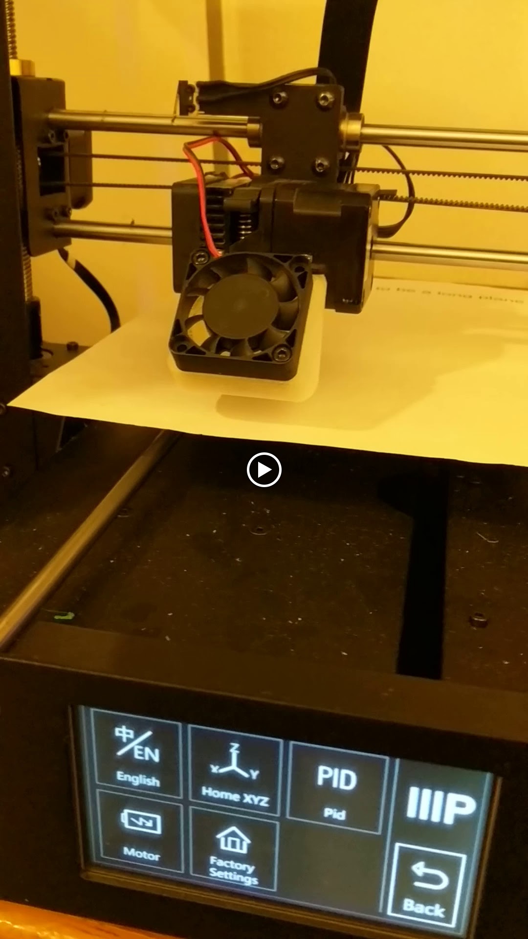

Any notion what might cause this noise? When homed, the printer mis-positions in X.
Any notion what might cause this noise? When homed, the printer mis-positions in X. When moved manually, the movement as normal (for this printer). This is a Monoprice Maker Select Plus (which is a re-branded Wanhao Duplicator i3 Plus -

@Adam_Steinmark Can’t say your wrong but when he was manually moving the carriage it seems to be smoother sounding on the motion but still sounded a little grindy to me. When using the stepper to move it the top belt was vibrating quite badly which would seem to indicate a stepper vibration issue.

i would agree with the guys suggesting mechanical problems. The sound seems to come from the belt slipping over the gears on the X stepper motor. one ovious reason for that seems to be that the X belt is too loose. tighten it.
If the tightening of the X belt doesn’t fix your problem, check the X stepper gear. if both are ok, check the bearing of the extruder carriage, perhaps add a little silicon grease, it seems a little hard to move (from the video i can’t tell exactly).

Apparently, the problem is not the controller (my first guess).
Swapped the connectors on the controller that go to the X and Y motors. Doing X moves from the control panel now moves the bed (in Y) … smoothly. Doing Y moves from the panel now moves the printhead in X … roughly (as before).
Another clue: When doing X moves from the control panel, the actual direction of the X move seems to be random, rather than the direction commanded. In fact at times it alternates direction in a single move.
Did try re-seating the connector, at the X-motor, of course.
Either the wire/connector or the motor for X, it seems…

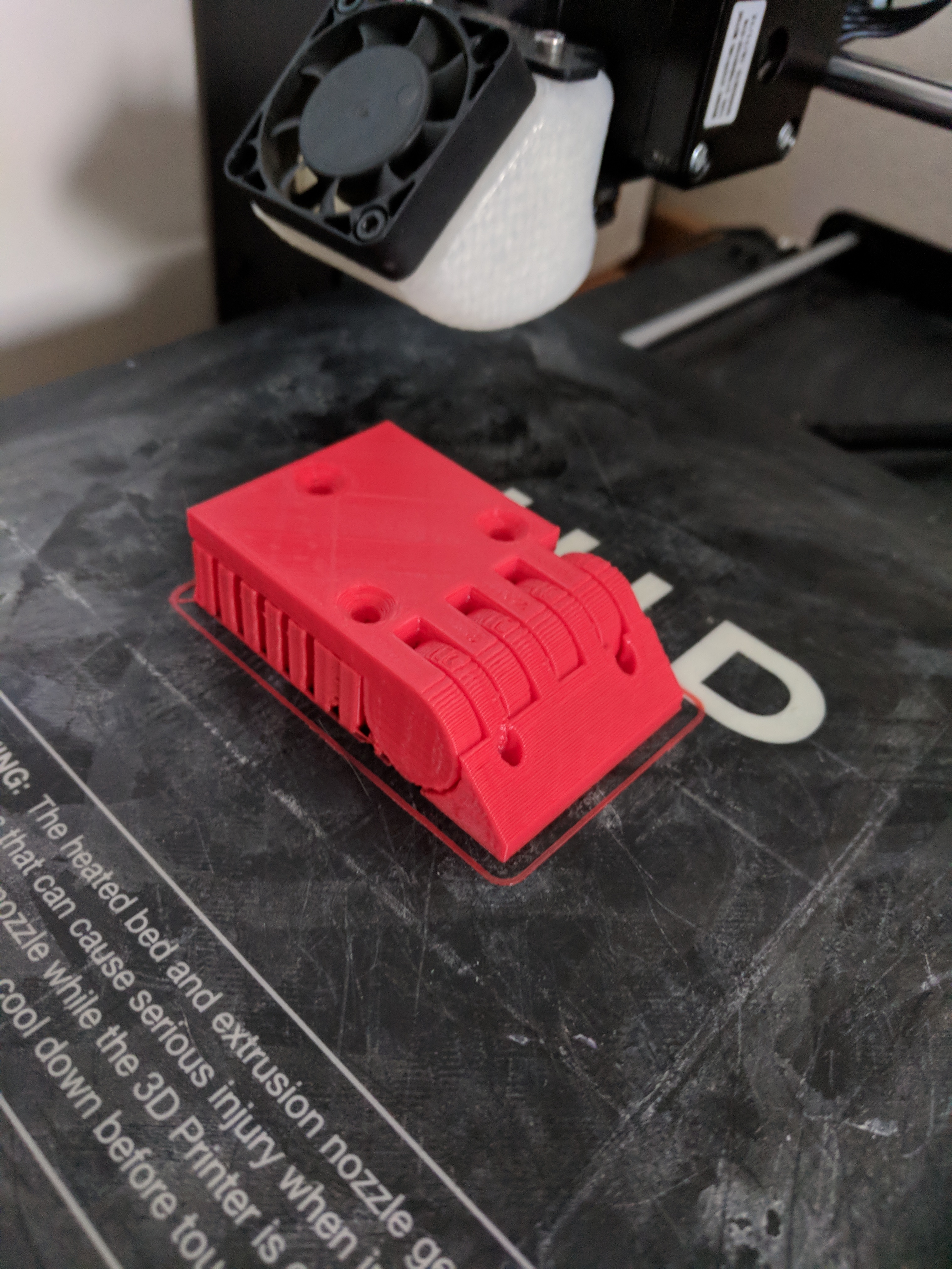

The below is meant to serve as a door-hinge for a printer enclosure.
