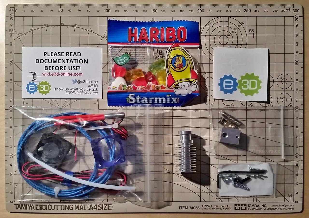

Realy didn’t expect to get Haribo gummy bears within package from #E3D guys. But maybe it is a part of English humour and some hint for their continental customers. :wink: So, now to find a courage to upgrade from Ubis on my Printrbot… It is a bit painful process.

I presume that Haribo either give companies bags for free or at a massive discount as a way of doing cheap sample distribution. I’m always receiving them with orders from random companies for no reason.
