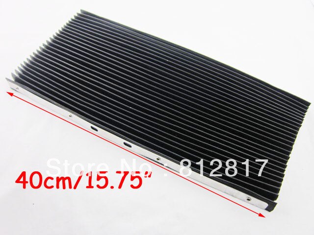

I payed 100eur for 2x 400mmx45mm .
Yes, expensive. But better to invest in this early instead of after the shavings have degenerated the precise ball screws.

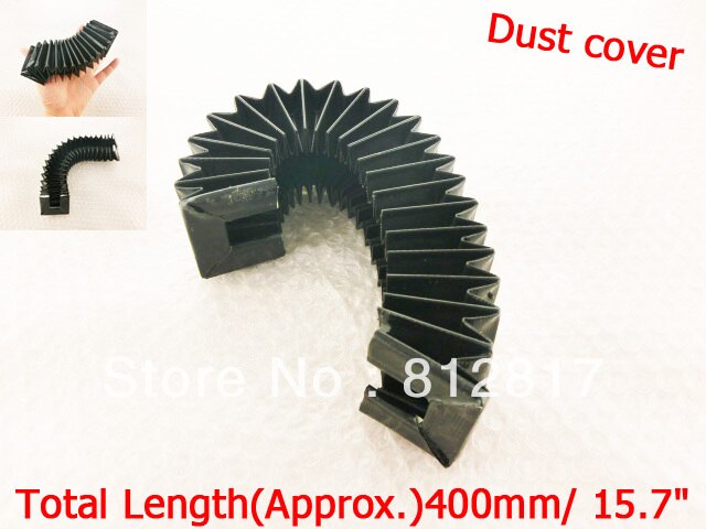

14eur/piece, no customs since we are below the minimum, free shipping from China to Europe (not unusual).
Yes it could work but its not much of dust resistant. If you dont want to do lot of work I would suggest just cover the bellows with the umbrella cloth so it would move freely and does not get tangled
I asked for 120x50mm U shaped for the Z-axis and will probably run this in the chanal of the X axis:
The important ball-screw is in the center and the smooth guide rods far enough from the sides too. So all dust would fall right through and no metal shavings get cought up in the ball screw bearing.
Great, they can custom make one for my Z axis for just 38usd with free shipping to Europe.
