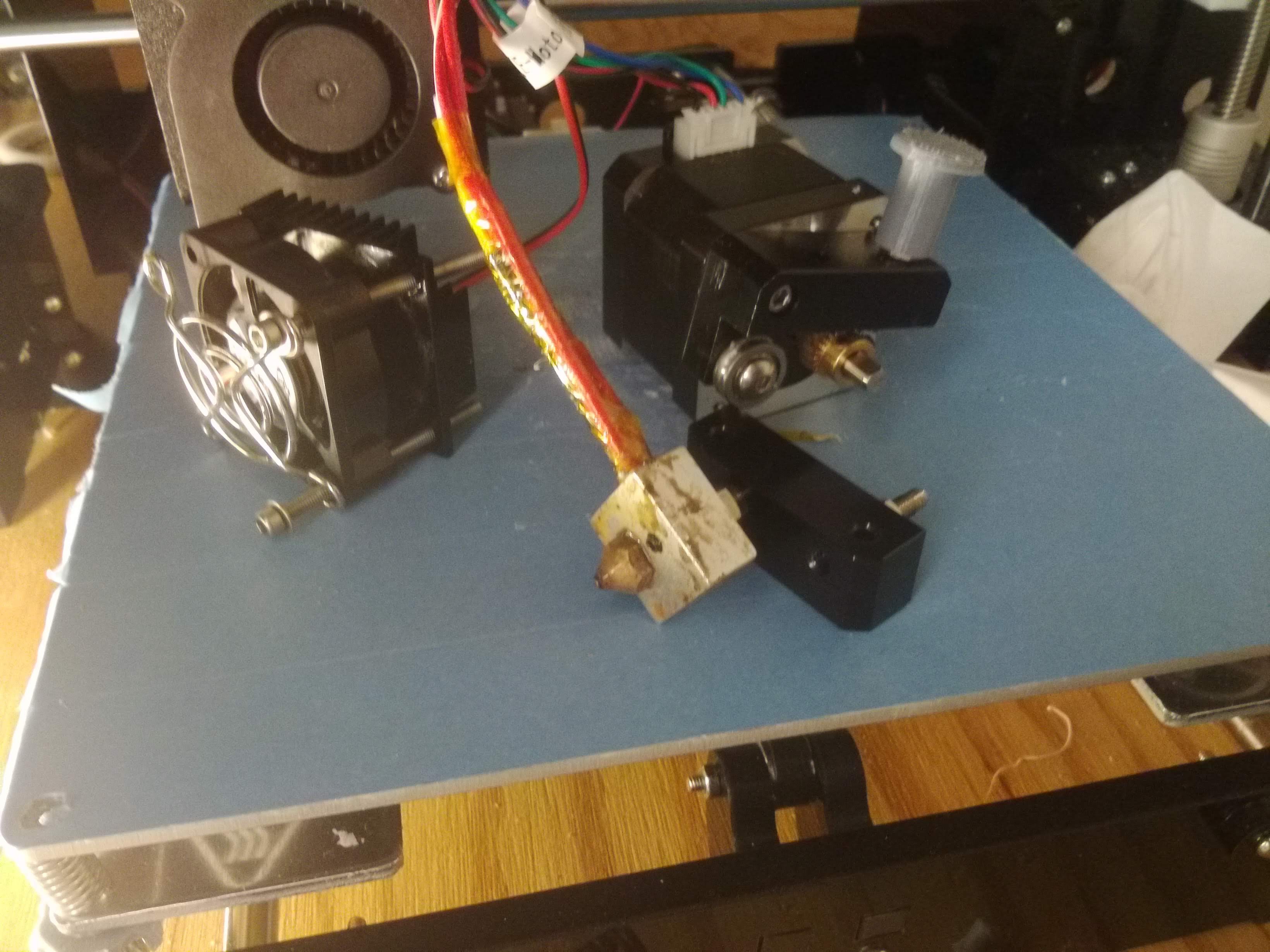

Any suggestions how to clean a nozzle?
Also is it normal that ABS won’t extrude with 240°C ?
It seems like your Nozzle is jammed.
