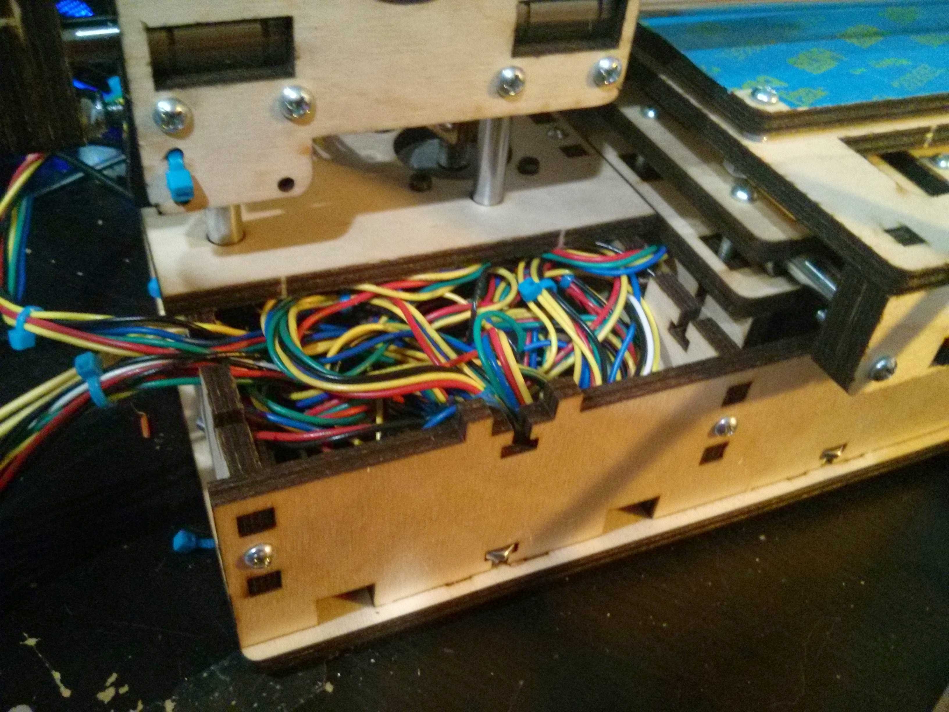

Any suggestions? Originally shared by Bill Bradford See the rectangular hole at bottom left?
Any suggestions?
See the rectangular hole at bottom left? That’s where the MicroUSB cable plugs in. What I need is a cable, or even just an L-shaped adapter, where the connector or cable goes up at a 90 degree angle after the plug part. That way I can anchor the adapter or cable to the printer body, and not have to worry about the cable sticking out from the body and getting bumped, and screwing up the $120 Printrboard. Suggestions?

You could solder a USB cable to the leads on the board, and let it hang out as simply a cable with a usb receptacle on the end… ie extend the receptacle out of the box, or even through the holes that all of the pretty colors are coming out of…
There are many other things to worry about with the Jr the cable is the least of them…
Brian, I’ve been very happy with my Jr. so far, got some amazing prints out of it the first night I fired it up after assembly without even calibrating. The USB cable sticking straight out of the side waiting to be bumped just bugs me :slight_smile:
Scott: that’s what I’m trying to do with some sort of right-up-angle MicroUSB adapter or very short cable, with the existing jack (don’t want to solder anything).
Yeah, I have a love hate with mine. IIRC they fixed the usb connector issue with either a better board layout or part not sure which. Never had a problem with mine. Look for a right angle micro b cable on amazon.
They do make cables with right angle micro-usb. Try Amazon. I got some for my phone, just so it wouldn’t stick out so far.
Monoprice.com is going to have all kinds of extenders and 90 degree adapters for dirt cheap.
http://www.ebay.com/itm/90-degree-Left-angle-type-micro-USB-B-male-to-mini-B-female-connector-converter-/400332381062?pt=US_USB_Cables_Hubs_Adapters&hash=item5d35ab5b86
This is what I can find, but the angle is going off too soon to deal with the 6mm ply.

Here’s a project idea for you: design and print a printrboard housing where you don’t have to let the stepper drivers swelter in an enclosed box with even convection blocked off by bunches of wires stashed in.
(At least turn down the stepper pots as far as possible soon, that will reduce heat in both drivers and steppers considerably)
