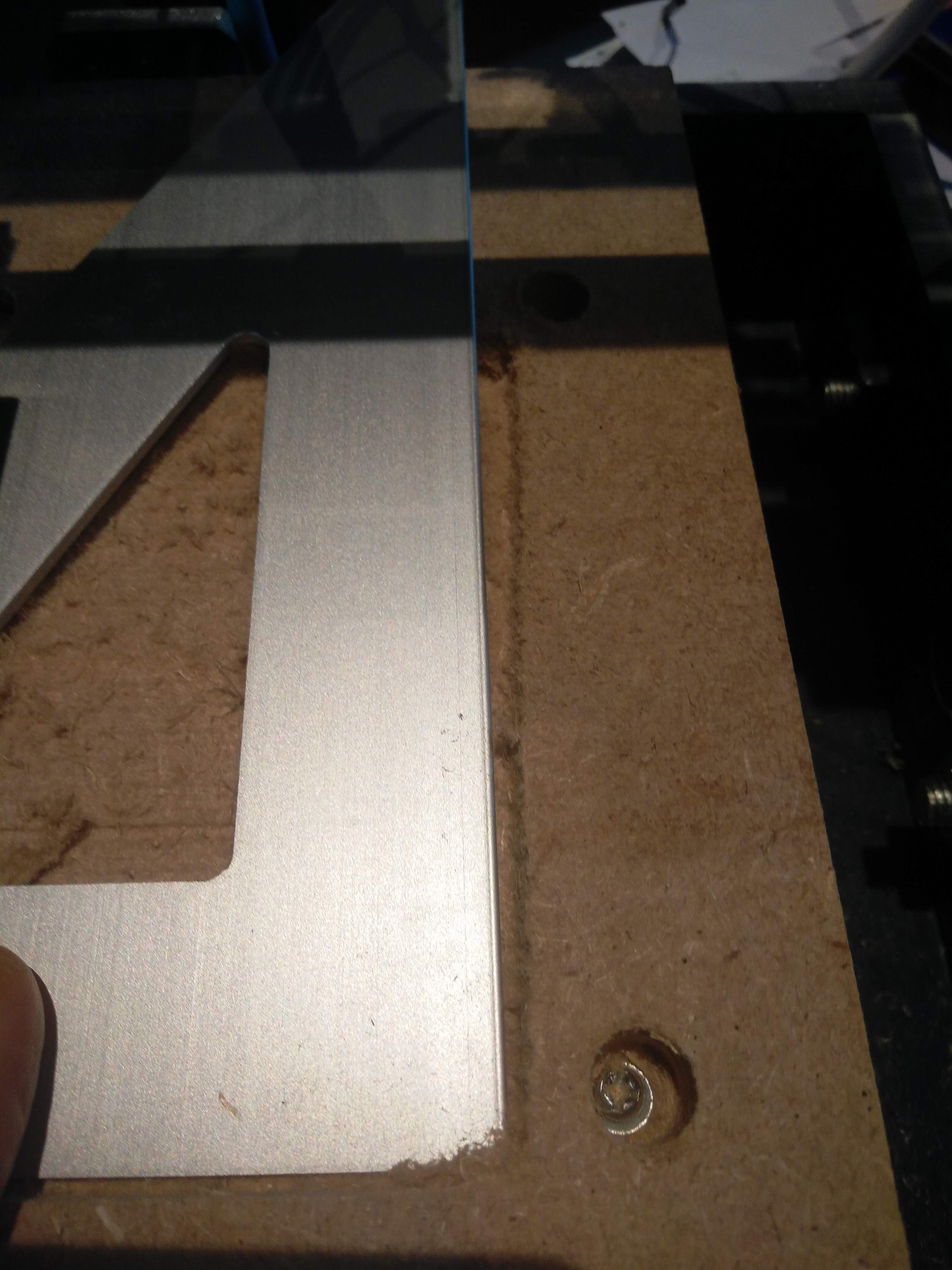

Any thoughts about what could cause mid-work significant x-drift? I am trying to mill a simple pocket to create a level base. I start with an outline to ensure squareness. That works fine and the edges are at proper right angles. Then run some gcode to mill progressively deeper (0.75mm per pass at 500mm/min and a final pass of 0.1mm at 100mm/min. The first half of the run works fine. Then suddenly the x axis skews progressively positive. Photo attached.
In the first photo you can see the right edge gradually moving away from true. And in the second you can see the pad being left behind on the left side as the x=0 gradually moves off to the right.
Note that the outline on the left side shows a true square (third photo)
