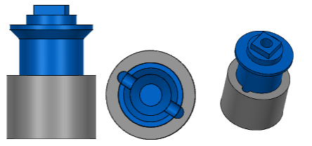

Yea, I think I’ve managed harden my prints a bit more by fixing print settings. Right now I’m trying to print a modified version of the axel shaft, see it here http://imgur.com/a/YVHbU
if that doesn’t improve it am thinking about making the hole thing into ONE solid, and pause the print in half to put on the bearings. Kind of dirty, but might be worth a try. I’ll upload the step if I see any improvements of the testing

Cool, I’m testing the other 2part model I showed in a link above. Seems pretty good. Making it to one single solid with a pause to out on bearing would eliminate one more week point in this part. I’ve pretty much have a finished stl for that if you want me to upload it
thanks David, will do. I am still in early stages.
@Benjamin_Groves I’ve uploaded the “one part model” at https://grabcad.com/library/openrc-1-10-axel-shafts-1/, feel free to test, redesign, do what ever you want with it. I haven’t tested it my self, but it’s dimensionally correct and adopted to be able to put on the bearings mid print.
