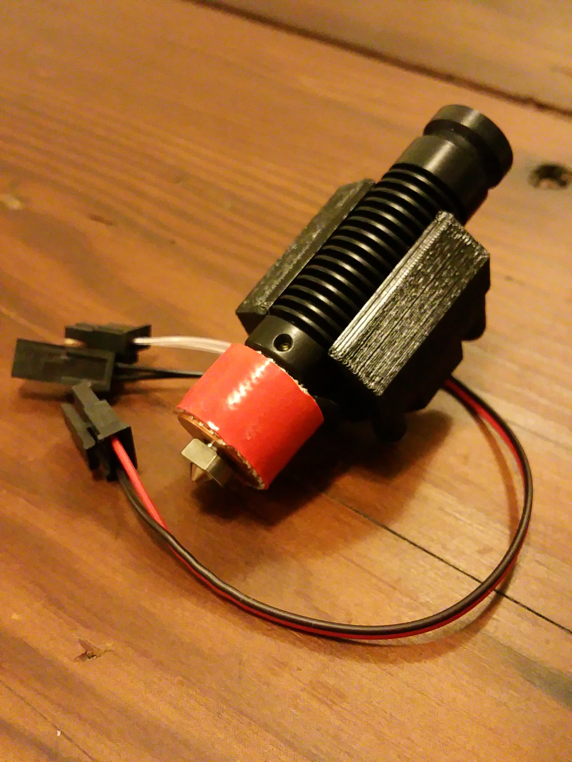

Any tips on using the new @Printrbot Very Metal (Black!) Ubis Hotend? Just got mine and planning to wire/fire it up this weekend (may have to modify the carriage of the GO! V1 to make room for the fan). Any advice on settings? Same thermistor tables in Marlin? Is 0.5 mm still about the max for retraction? Wiring advice? Experiences?

I’ve had two for about 4 months now. They are awesome hotend!! A couple things I would say:
Definitely reprint the fan shroud. I found mine that was really tight initially to be sliding down now. Also double check that the tip is tightly screwed in. Mine became a little loose. @Brook_Drumm might be able to give a little more insight into this but I believe there was a retraction threshold you needed to stay in. I use a bowden setup so I use a different value.

Without getting into the weeds, the heartbreak is longer- so up to 1mm retraction. I start with 0 and work back so you aren’t wasting time with some ridiculous retraction you don’t need. Quality is best with the most minimal amount of retraction possible.

Also forgot to mention. Unless the thermistor has changed I the revision it’s the same table that the original Ubis uses. I just copied the Pid values from the normal printrbot marlin

Thanks @Brook_Drumm and @Griffin_Paquette , it turns out I’ve got to print a new mount for my active cooling fans first (it’s donut shaped and too tight to accommodate the fan on the hotend) but at least I don’t have to modify the carriage itself. With any luck I’ll get printing with the Metal Ubis tomorrow. I’ll report back.

Whatever Carl did to these hotends, it’s magic. Nice smooth layers, no strings, and all after just a few hours of playing with it and dialing it in.
And I solved my fan problem by using a spare 4-pin power extension cable and a bit of solder.
