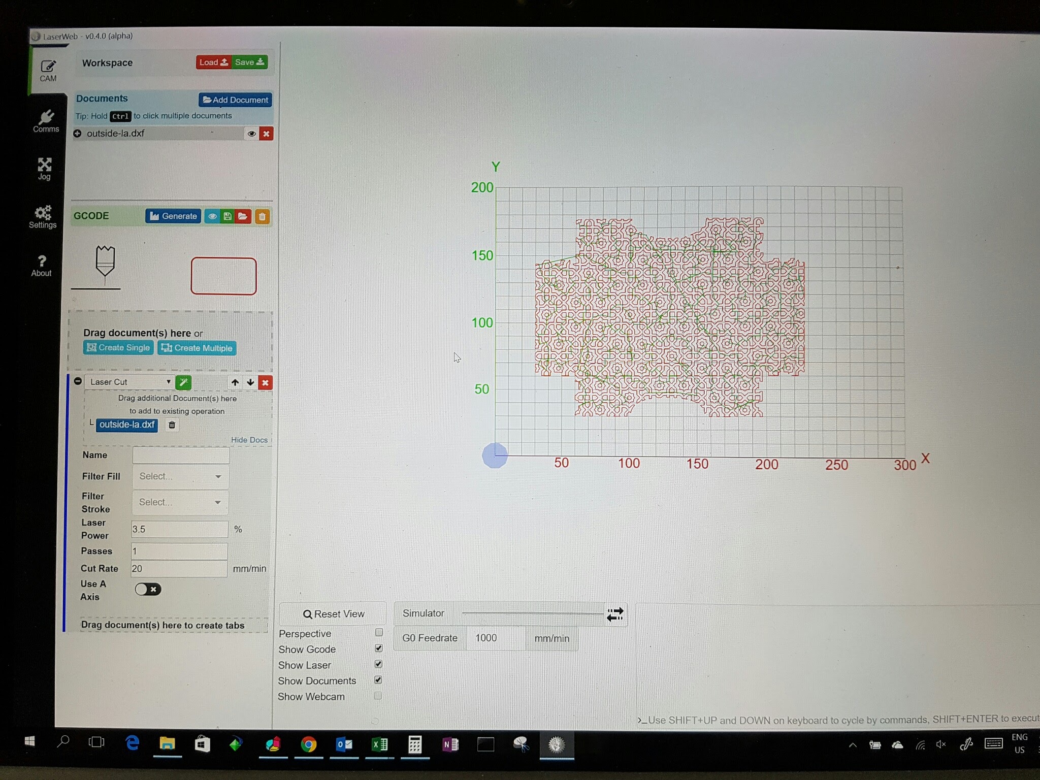

Anybody else have problems generating gcode with this save/jason file in lw4 gh-pages?

Maybe it’s giving you a hard time because the polylines are exploded in lots of pieces? Try to join them perhaps
I am not sure what you mean.
If you drill down the object tree in the left in LW4 I click the dxf itself in the canvas you’ll see that it’s composed by many many small polylines. Maybe you could try joining them ( if the design permits )
Yeah that makes sense. I was just being impatient. The progress bar doesn’t work so it makes me think it is hanging. I notice that your cpu is much faster then mine. I am using a 10 year old xeon. You have a fancy i7. That probably makes a difference.
@Kris_Backenstose ​ questions: in the original file is the color stroke white?
No but its exporting to dxf r11 from corel x7 so not sure what is going on. Why do you ask?
Because there are some issues with dxf in LaserWeb4. When I loaded your workspace the paths where white and I could barely see them. Please draw a simpler shape export it and send me that file
