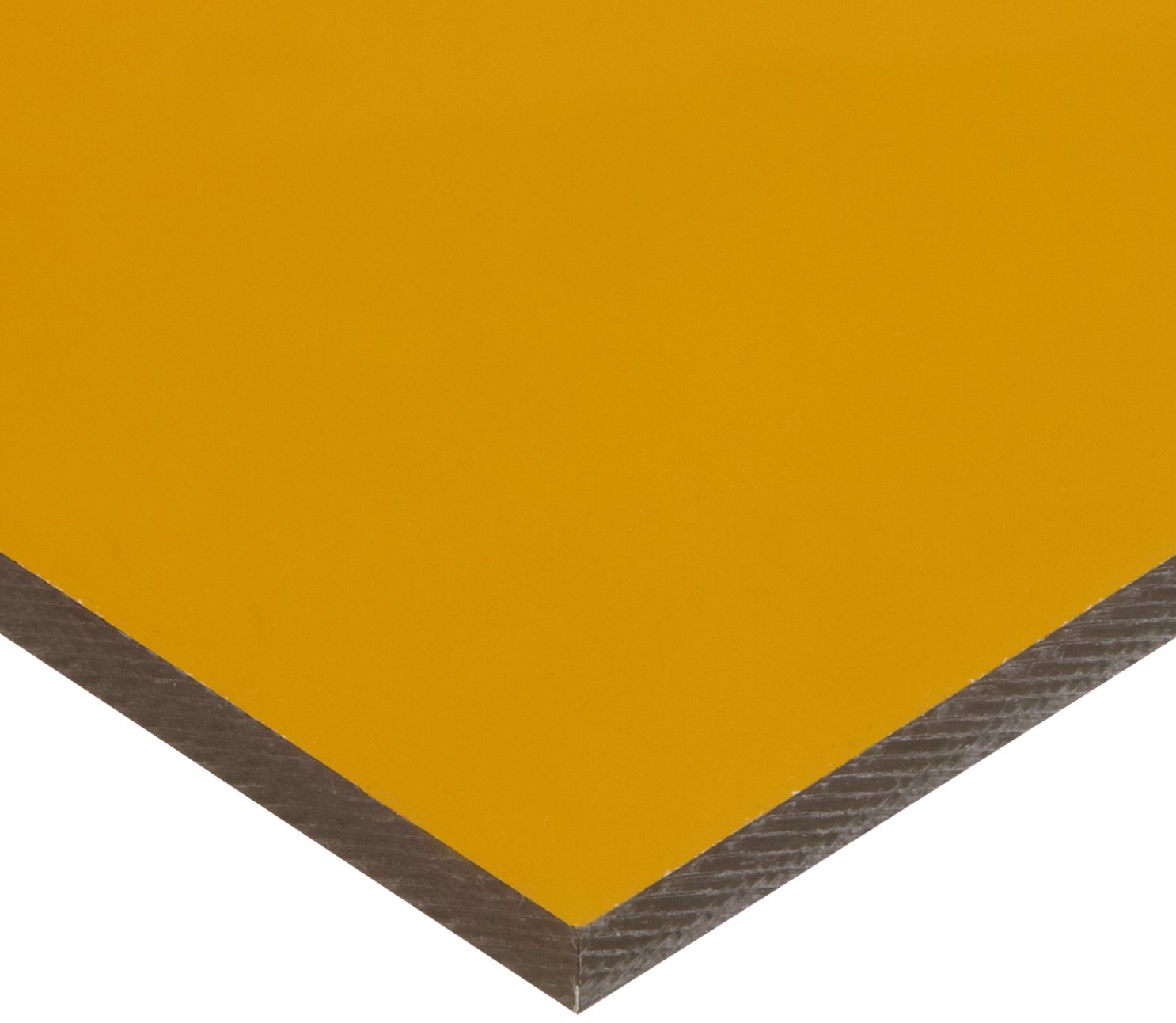

@Eclsnowman @Daniel_Salinas Have you tried PEI (Ultem) sheets? I’ve been using the material for ABS/PLA/PETT/PETG/PET+/Wood Fill for a couple months now on my MendelMax 3 and FuseMatic printers with much success. Only video I have printing abs on it during the MM3 beta https://www.youtube.com/watch?v=YsHL42JWx0A
Use .03" thick sheets. don’t go thicker. It’s an insulator.
http://amzn.com/B00CPRDDLY
Adhere to your build surface with 3M 468MP transfer tape. (a.k.a gorilla snot) laying down 2" wide strips is the easiest to use. You can purchase different lengths. http://amzn.com/B00P7K7T84

@Isaac_Arciaga thanks for the reminder. I have wanted to try yltem before. My big problem is sourcing a big enough sheet for my bed that is not cost prohibitive.
@Eclsnowman McMaster-Carr sells 12"x12", 1/16" thick Ultem Sheet for around $30. Seems like it would be perfect for your Eustathios, if you wanted to try it out.
@Joe_Kachmar the aforementioned Amazon link from @Isaac_Arciaga has 12"x12"x0.03" for $17.27, with free shipping via Prime.
