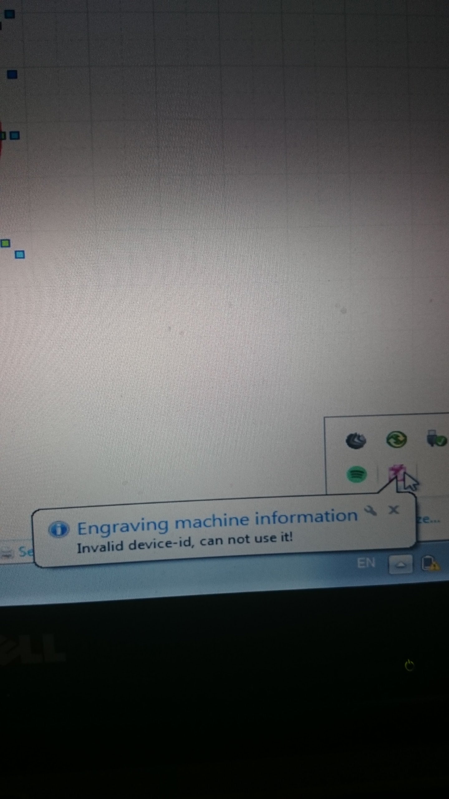

Anyone any idea how to solve this?
Open your k40 read on board serial and update that on corellaser.
if u use multiple k40(as me) and only one notebook…write board serial on top of k40
you need change that everytime
Engrave-> device inizialize-> device id …close and re-open software and use k40

By just putting the device Id into coral laser?
I’ll see if putting the code into coral laser works!
