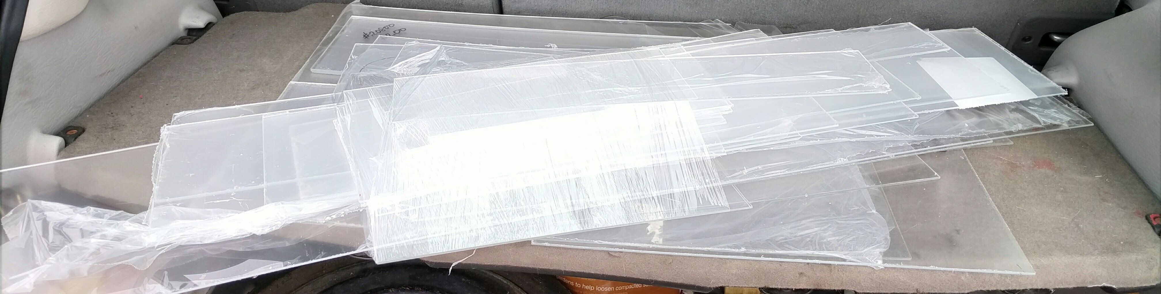

Anyone care to share their basic “starter” settings for cutting/engraving/rastering? I just got a pile of scrap acrylic from the local Lowes and I want to advance from cardboard…Much appreciated

How did you get the scrap? Did you have to pay or was it free? Just curious!
@Joe_Keneally The 6 larger pieces on the bottom (the ones not wrapped) I paid $1-3 each for. The wrapped pieces were free… Basically you go to your local Lowes or Home Depot and check out their bin where the stuff is cut. They are usually happy to get rid of it and maybe make a few bucks in the process. I paid less than $10 for that whole pile…

@3D_Laser Yes, this stuff has the clear tape coating on it and it does smell like superglue when cutting…
