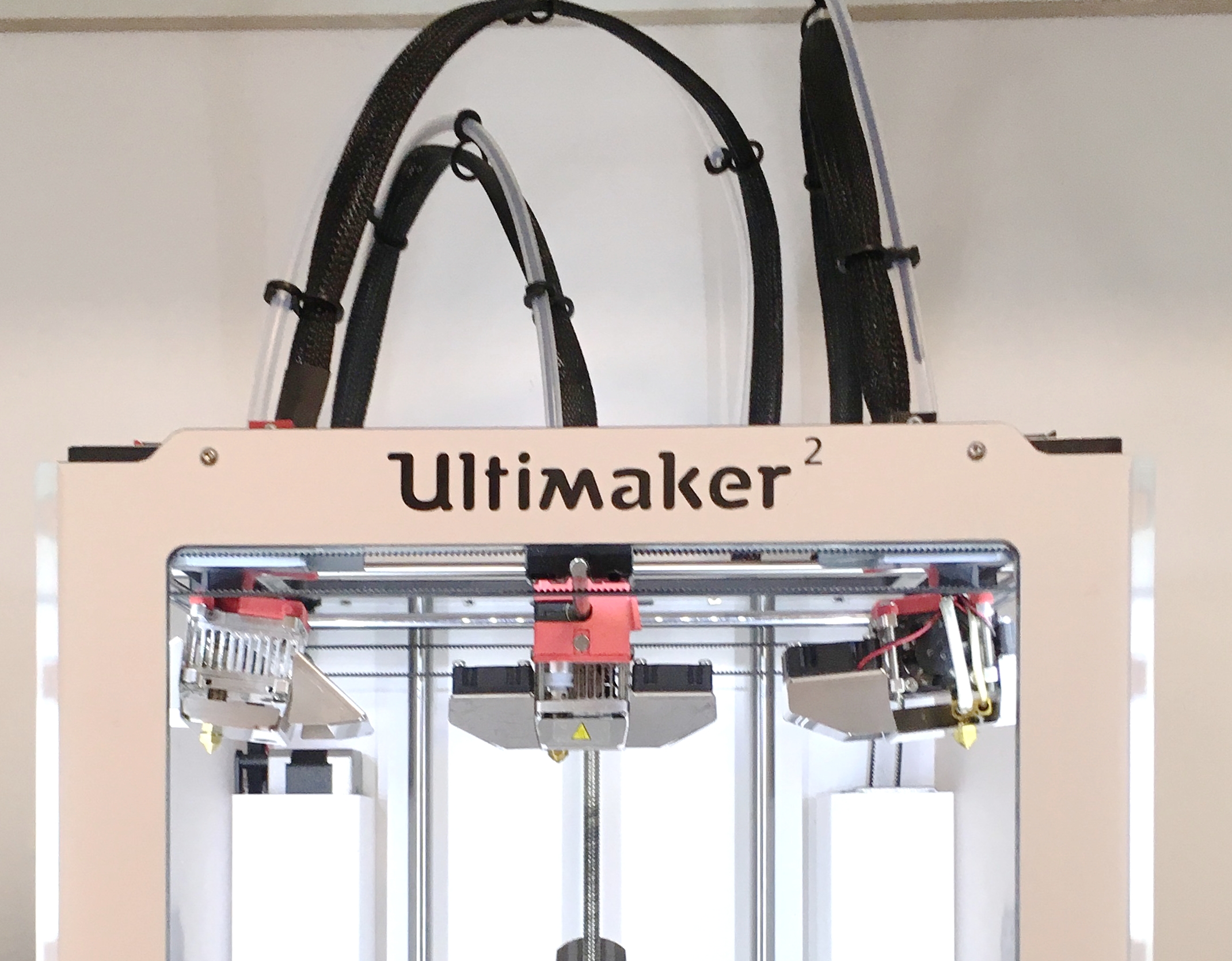

Anyone currently uses multiplexing to control additional hotends/feeders besides Prusa?
Anyone currently uses multiplexing to control additional hotends/feeders besides Prusa? We intend to upgrade the magnetic tool changer with a 3rd head later this year and we want to keep the original Ultimaker board and our customized Marlin firmware.
