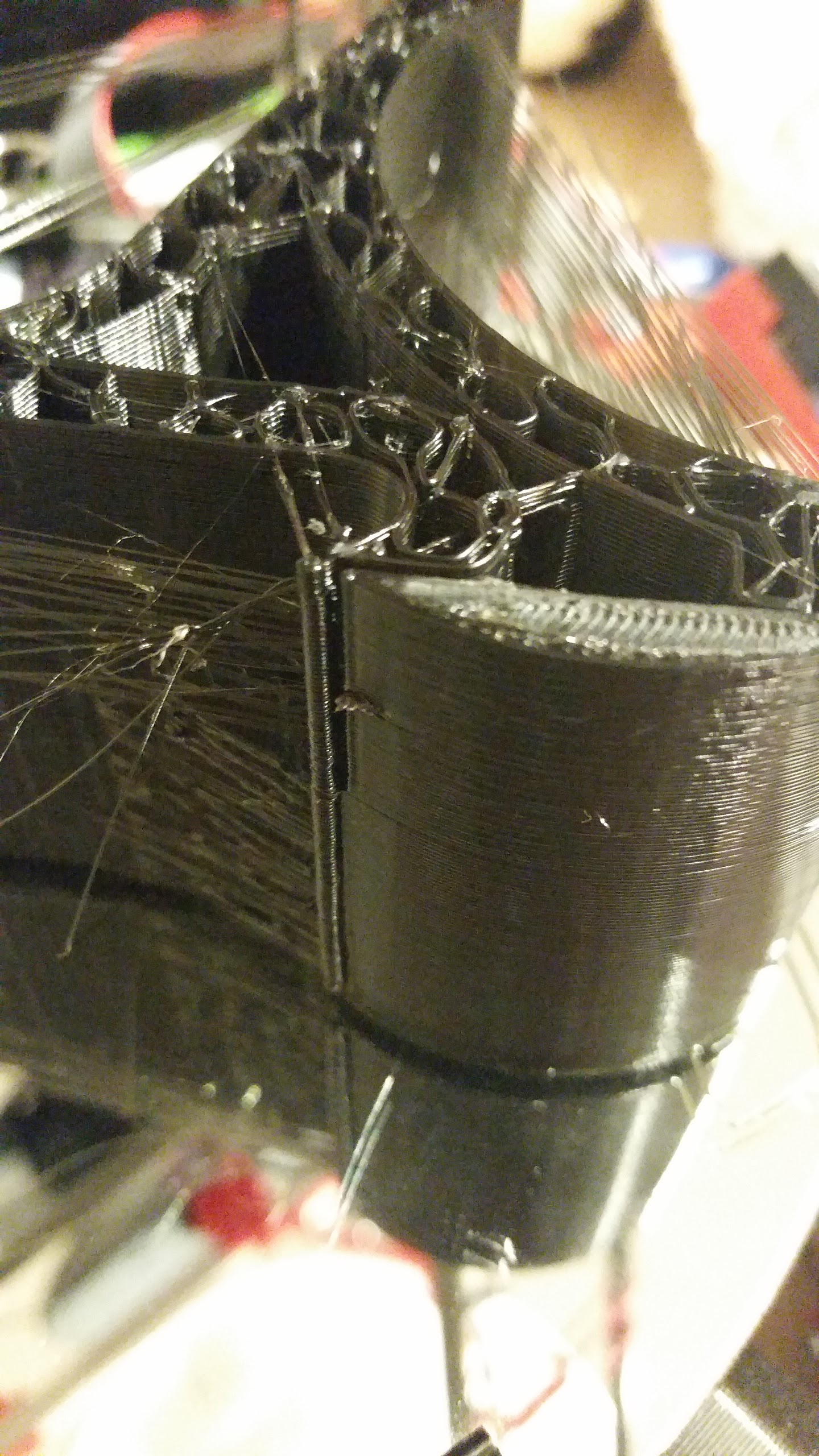

Anyone else been testing Slic3r 1.2.1? My Kossel Mini is half way through my phone stand print. I’m surprised just how much filament is going into support material to be ripped out when done. But it the final object is good it’s worth it. Maybe I should make a filament recycling machine too.
What is going on with all the strings? It looks like retraction is turned off or something, is that somehow support material? I’m curious to see the final product after you’ve cleaned it up (assuming the print finishes OK)
If finished okay. Some of the support material is proving hard to get off.
Haven’t tried 1.2.X yet. I gave up on support material in 1.x, finding it less than useless. I keep a copy of 0.9.10b around when I need support material. I draw my own whenever possible. I’d like to see/hear more about support in 1.2.X. Is it useful now? The problem was that they decided to have supports stick out beyond their region of support. This often put support material into voids of my print in ways that it could not be removed effectively. i gave up.
That’s the problem I’ve had cleaning up this print. It’s got a big void in the middle. http://www.thingiverse.com/thing:572700 It made me wonder if dual heads and water soluble filament for supports was possible.
