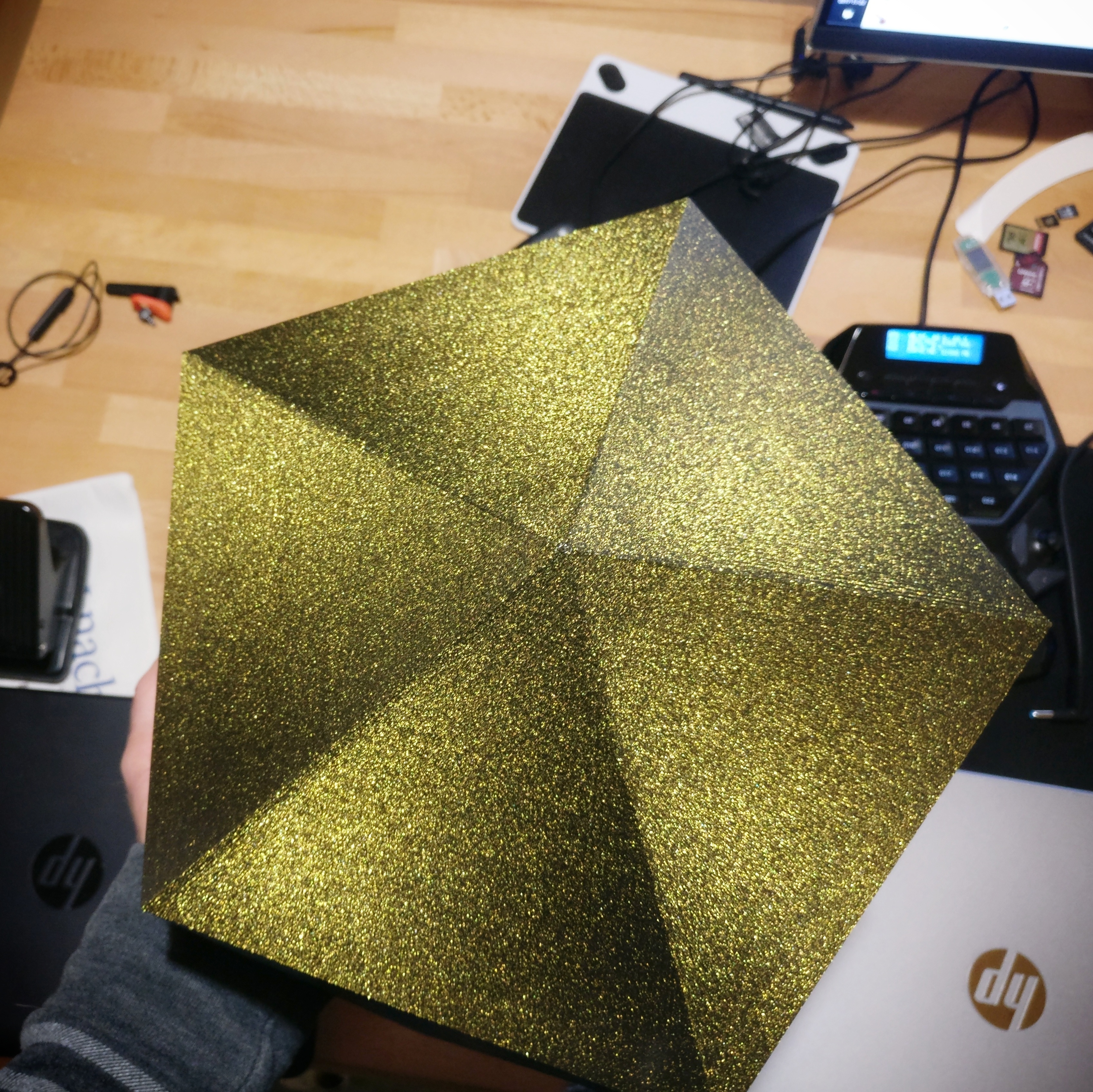

Anyone else do any worthwhile processing to their 3D prints?
Originally shared by Thomas Sanladerer
I did have to clearcoat the planter printed in @Fillamentum Vertigo Galaxy since there were some extruder issues visible in the raw part. But hot damn, the extra depth the clearcoat gave the part is mind-blowing!
