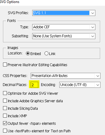

So I think I found the issue. In Illustrator my default svg setting was set to “3” (see below). When I changed this to “2” the processing went significantly faster and the status bar actually showed progress past 50%. I’m thinking that I may actually be able to use “1” decimal place to make it even quicker. Does anyone have any suggestions with saving SVGs?
CSS Properties should be Style Attributes
So after more testing where I’ve changed the decimal places from 3 to 2 to 1 on illustrator, and CSS properties to Style Attributes, I’m still having issues with LW not calculating gcode paths for specific parts of the svg file during mill pocket operations. Layers are correct in the svg, but for some reason the text will not process gcode paths when selected as a group. Individual characters work and some words, but if I select all text for one operation the processing time is very long and the output is blank.
