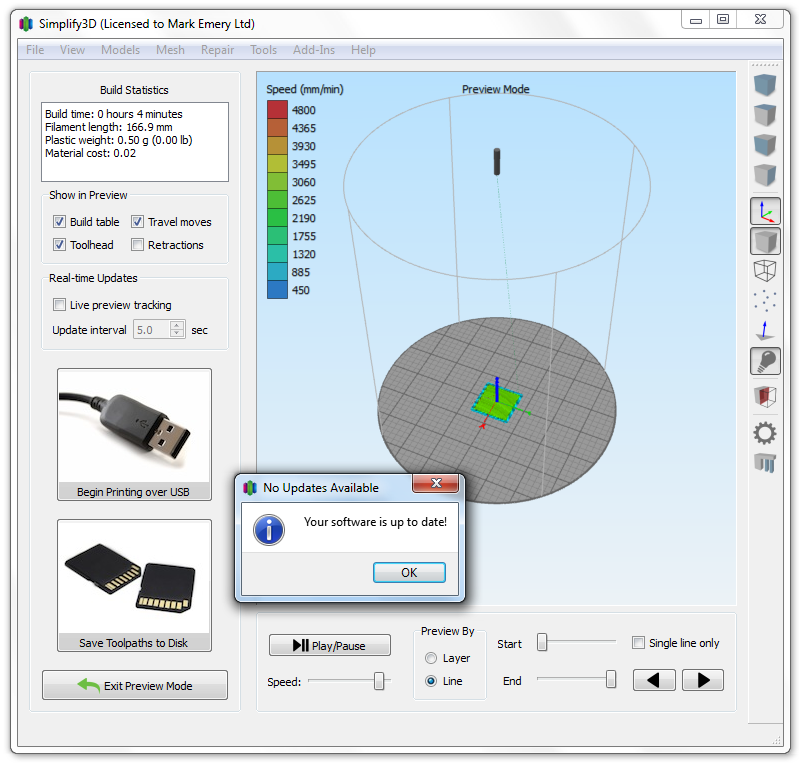

Anyone else seen Simplify3D do this? An open top test cube shows fine in the preview when imported, yet when prepared for printing it only wants to do the bottom layers. The start and stop values are empty, so it’s not that I’m clipping it.
Dumb question. What line width is set. If this is the hollow calibration cube, and extrusion width is thicker than wall width it won’t print it. Second question. What are your perimeter and top fill settings at?
Is the wall thickness of the cube less than the configured nozzle width?
It’s best to use a solid cube model and print with n perimeters at n width, n bottom layers, 0 top layer and 0 infill
An open top cube like you’re describing is non manifold. The walls have no thickness. So the slice is interpreting a 0 thick wall perfectly. You need to either make those walls thicker (I recommend 2x your nozzle or 0.8mm in most cases) or cap the top and use vase mode.
Ok. Slic3r and Pronterface had dealt with it without problems and without needing to set vase mode.
