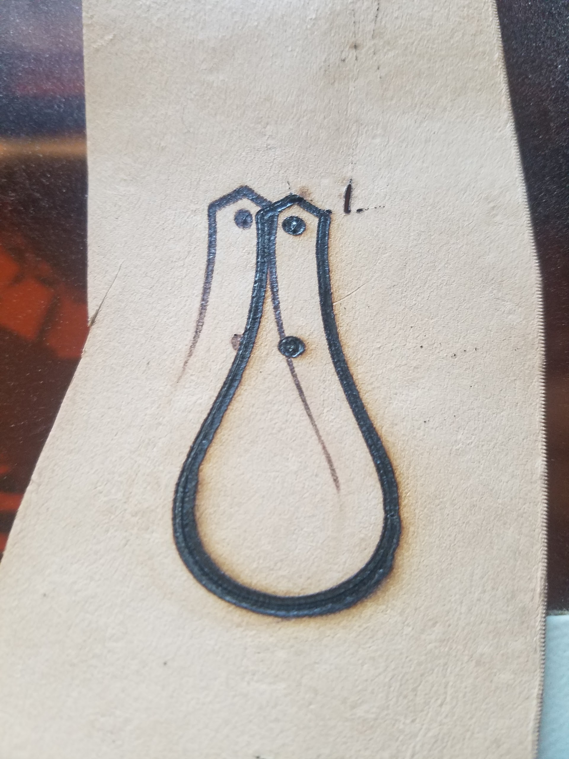

Anyone ever had a split laser? This would be great for cutting multiples,
Anyone ever had a split laser? This would be great for cutting multiples, except they overlap. I just cleaned the mirrors and lens.
Very artistic…
Make sure the head is square with the second mirror.
Do you have air assist,beam hitting side of air nozzle
Yep, alignment issue.
Yup you guys were right on, had to square up the head. Thanks!
