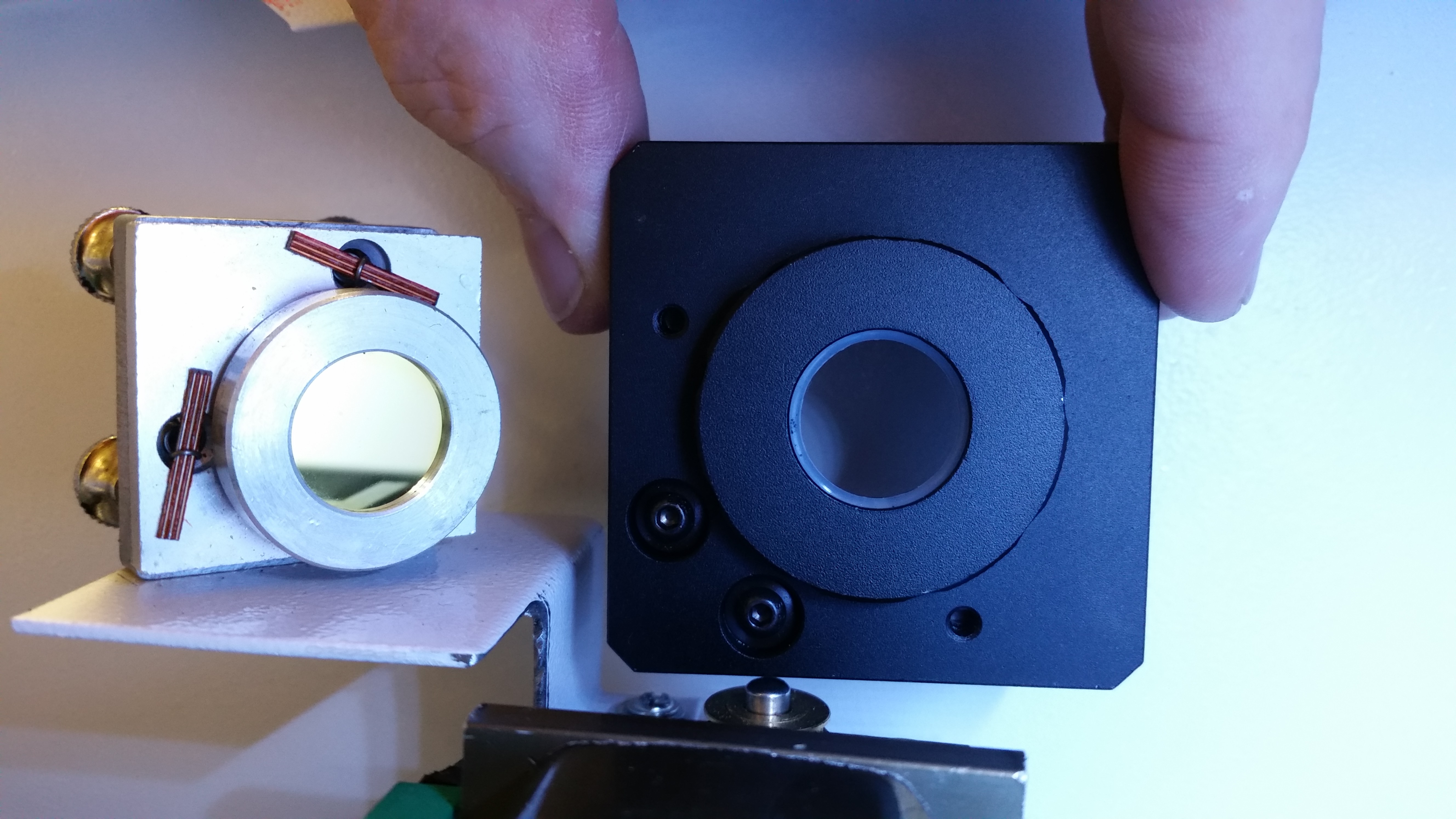

Can you post a pic with the new mounts next to the old? I don’t think a little extra weight will matter as that axis doesn’t move as fast as the laser head does.

Here is a picture comparing the size of the two. I’ve done some measuring and I believe will they fit without cutting an opening in the left side but it would be really hard to to get your fingers in there to adjust them so I’ll be putting in an access panel.
