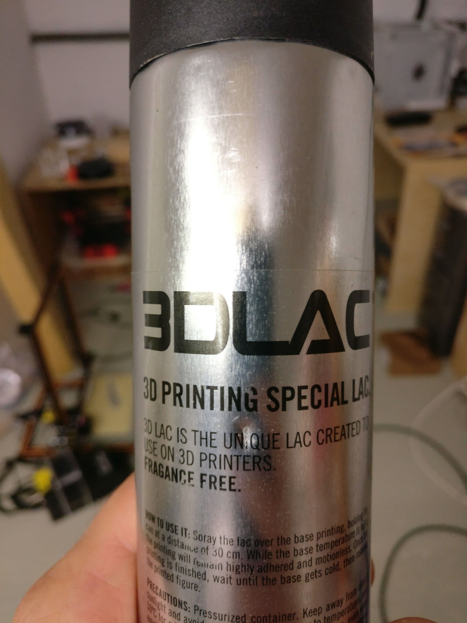

Interesting, I would have guessed it’s hairspray / 3DLac deposits. I’ll need to keep an eye on my printers, they use up a lot of polyester filaments

Also i used glue stick and hairspray at times and the power deposit appears in either case
Hair spray will not look like white powder unless you scrape it off the bed with a razor blade.
@NathanielStenzel ​ it does if the aerosol gets enough time to dry. I once had to clean up a Witbox @Nils_Hitze ​​ used to spray 3Dlac in, looked like a bag of cocaine exploded next to it.

@Thomas_Sanladerer what brand of hairspray? I use Aquanet Extra Hold.
@NathanielStenzel like, actual 3DLac
But can you get all day hold for your up-do with that?
@Stephen_Baird ​ yes. In fact, @Sanjay_Mortimer ​​ can vouch for that.
3dLac != hairspray
