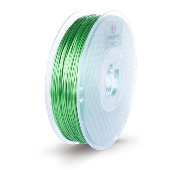

Anyone ever tried printing with Polyalchamy green?
Anyone ever tried printing with Polyalchamy green? It looks like silk but not sure it’s actually silk. Been having nothing but trouble with it jamming up. Only filament we’ve had jam thus far. My best guess is that it has to do with something about how it has sharp bends in the filament and it therefore doesn’t go through the bowden tube easily.
I’ve printed the Beaver3D stuff which is supposed to be the same without issue.
@ThantiK What temperature and speed do you print that stuff at?
230C 55mm/s
