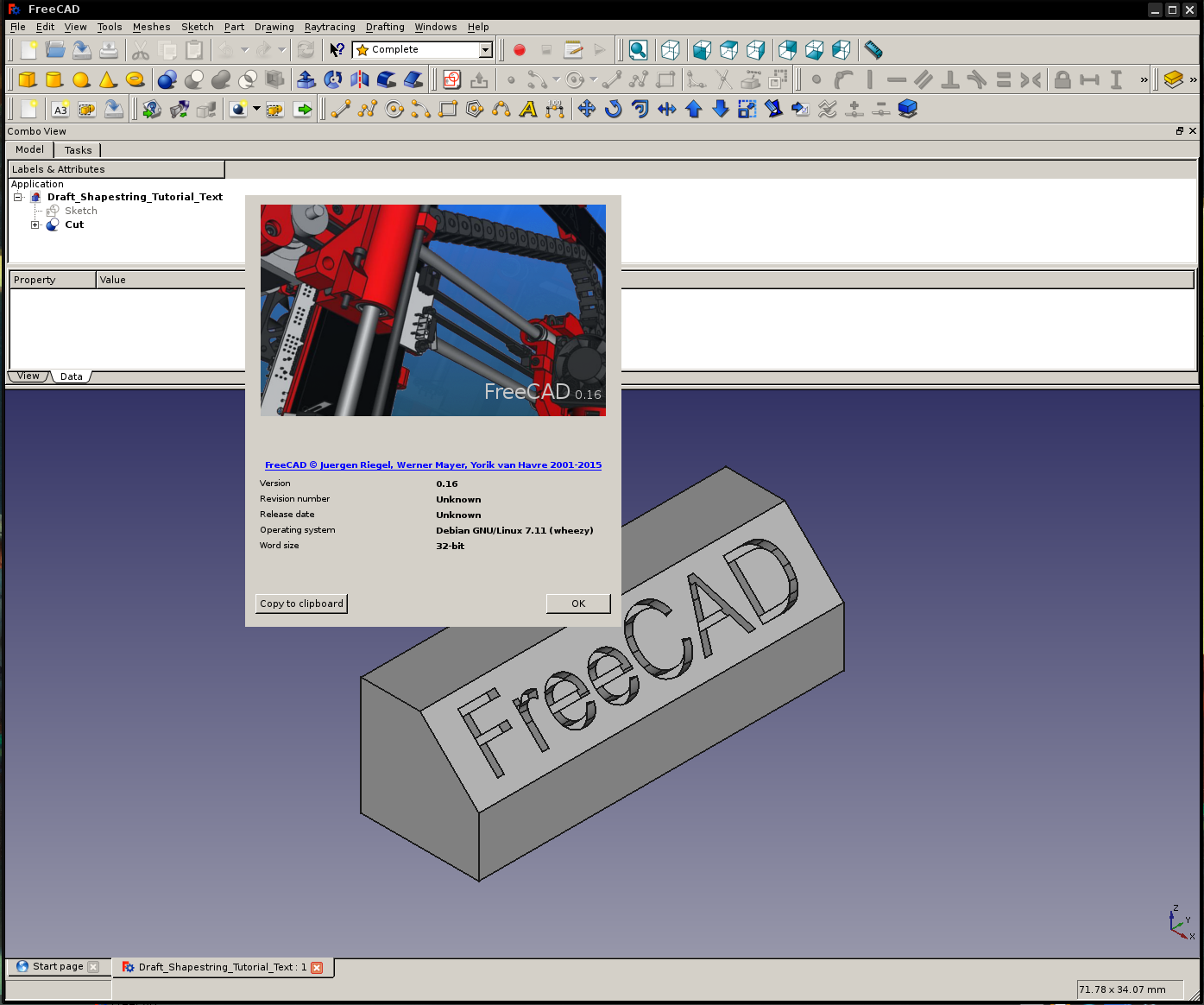

@Greg_Copeland I tried to build the git pull yesterday of FreeCAD but it bombed out on me here. Cmake ran and it seemed satisfied with my build environment. Based on the error I can only assume there is something wrong with the code. It sounded to me like someone could not count to three? I know it can be hard sometimes. But I got v. 0.16 running. which is more than I can say for my efforts trying to build LibreCAD.

@Greg_Copeland 0.17 would not build for me when I Git pulled it yesterday. I’ll keep an eye on the change log and see if anyone fixes it. Maybe I’ll submit a bug report? For now 0.16 is good enough.

@John_Bump well I tried to build 0.17 but the goofs apparently can’t count to three.
@Greg_Copeland I do seem to be missing some buttons. I’m trying to follow along with a tutorial and things they have I can’t find. If someone would post a snapshot of 0.17 that builds I’d compile it. In a while I’ll update my source tree here and try again. Or I’ll just wait until they have a tarball of 0.17. That shouldn’t take more than a couple of years.
