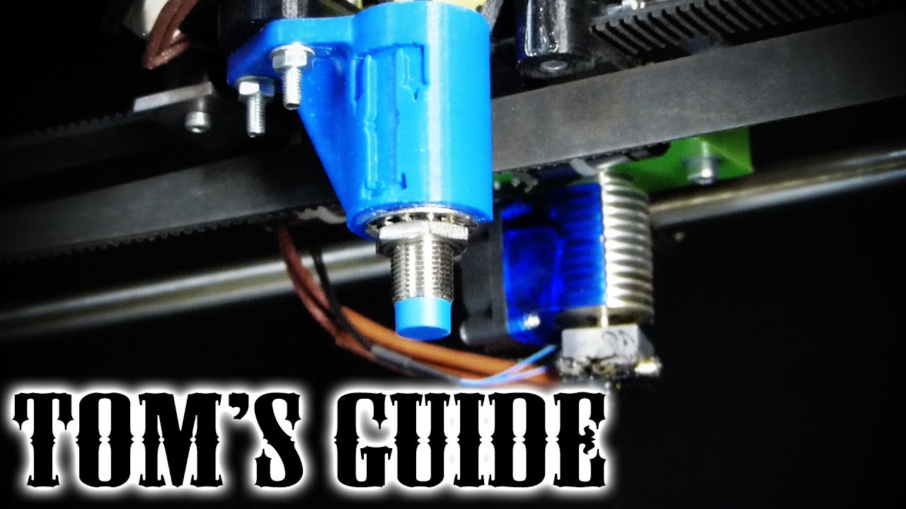

anyone got a link for the Inductive Level Probe used in the spartan? no idea on any of the needed specs
Started with that part last weekend, these links might help you too:
3D printing guides: Setting up auto bed tramming leveling tilt compensation
Geeetech 2560 and level probe
The described part has a smaller diameter, but you can print an adapter for the holder with your second printer
- I have an stl file for that
Yes. But a straight link to the part is what I was looking for. I’m looking for least amount of stray parts as possible so my results are as close to stock as possible and therefore easier to troubleshoot
Also I’m pricing it out
Thank you for your input though!
6-36VDC 4mm Detecting Distance NO Inductive Proximity Switch LJ12A3-4-Z/BY https://www.amazon.com/dp/B00DUYSWXK/ref=cm_sw_r_cp_awd_8NJhxbD8T969E
I recommend the 8mm distance probe: LJ18A3-8-Z/BX 8mm Approach Sensor Inductive Proximity NPN NO Switch DC 6-36V https://www.amazon.com/dp/B008FZC8F2/ref=cm_sw_r_other_awd_oocixbMHDFW87
Also you need a voltage divider so you don’t burn out the 5v input z-min pin. These make tuning the probe output voltage to 5v dead simple: 10 Pcs Variable Resistor Trimmer Potentiometer 20K Ohm 3296W https://www.amazon.com/dp/B008MLGLS4/ref=cm_sw_r_other_awd_.pcixbCCM685X
