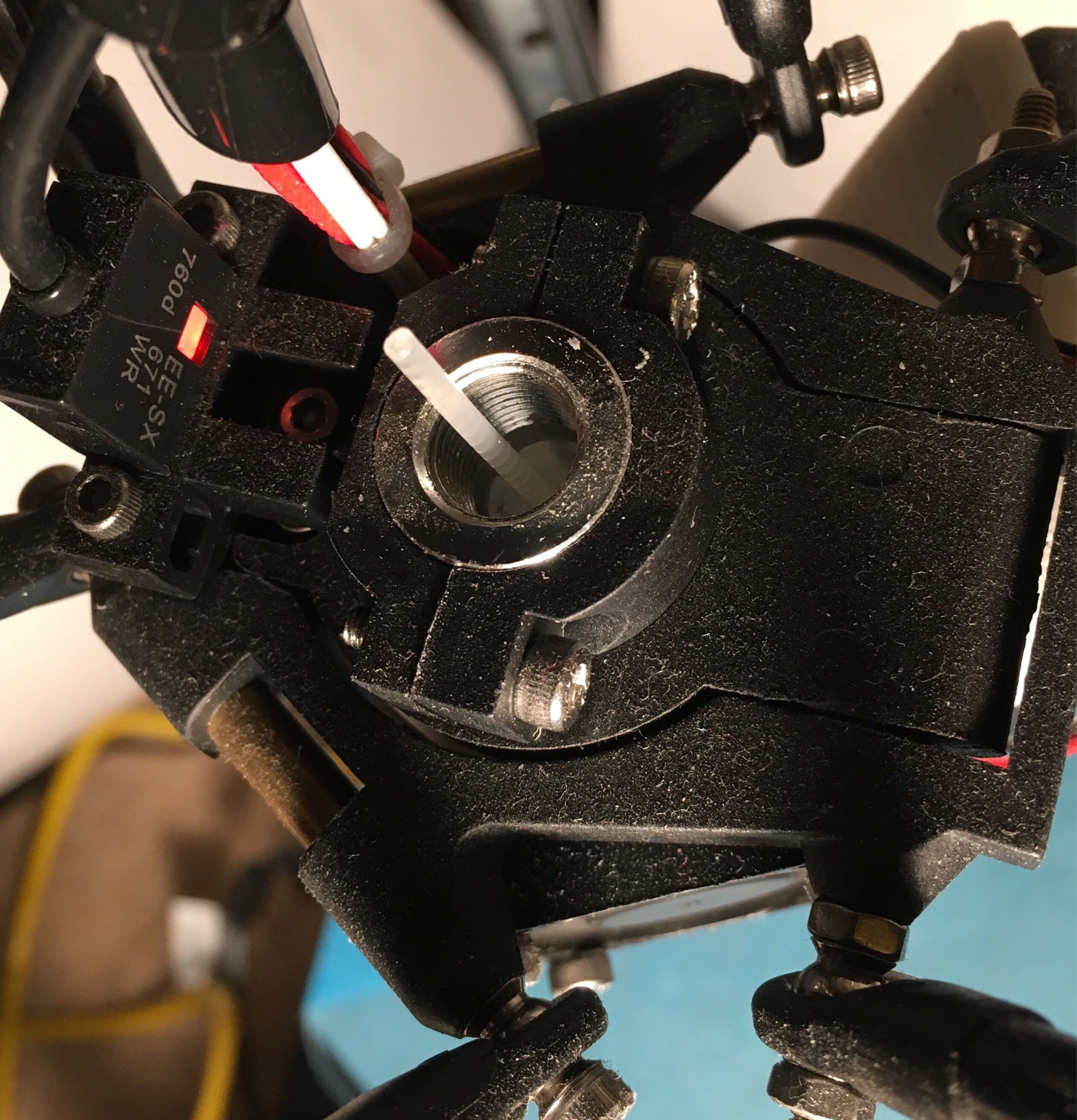

Anyone got broken filament on a regular basis? This time, it broke in two places apparently at the same time. (First time was with the original filament shipped with Ares - Sign in - Google Accounts).
Then, when @Ivan_Hoe asked for a picture of the sensor adjustment screw, I checked back as I remember picturing the top of effector. Indeed, the first picture in this one shows the screw on the left of the broken end. Talk about timing.

Finally I remembered that the lower end of the catheter could be screwed off. There was no heat in the metal screws. Once open, I saw another broken end inside the effector. Using a tweezer, it did not require too much effort to remove. (The first picture shows the broken end half yanked up. The full stretch is in the second picture, revealing the melted tip.) Phew - again. It is not time to worry yet, like Atticus Finch used to say.
