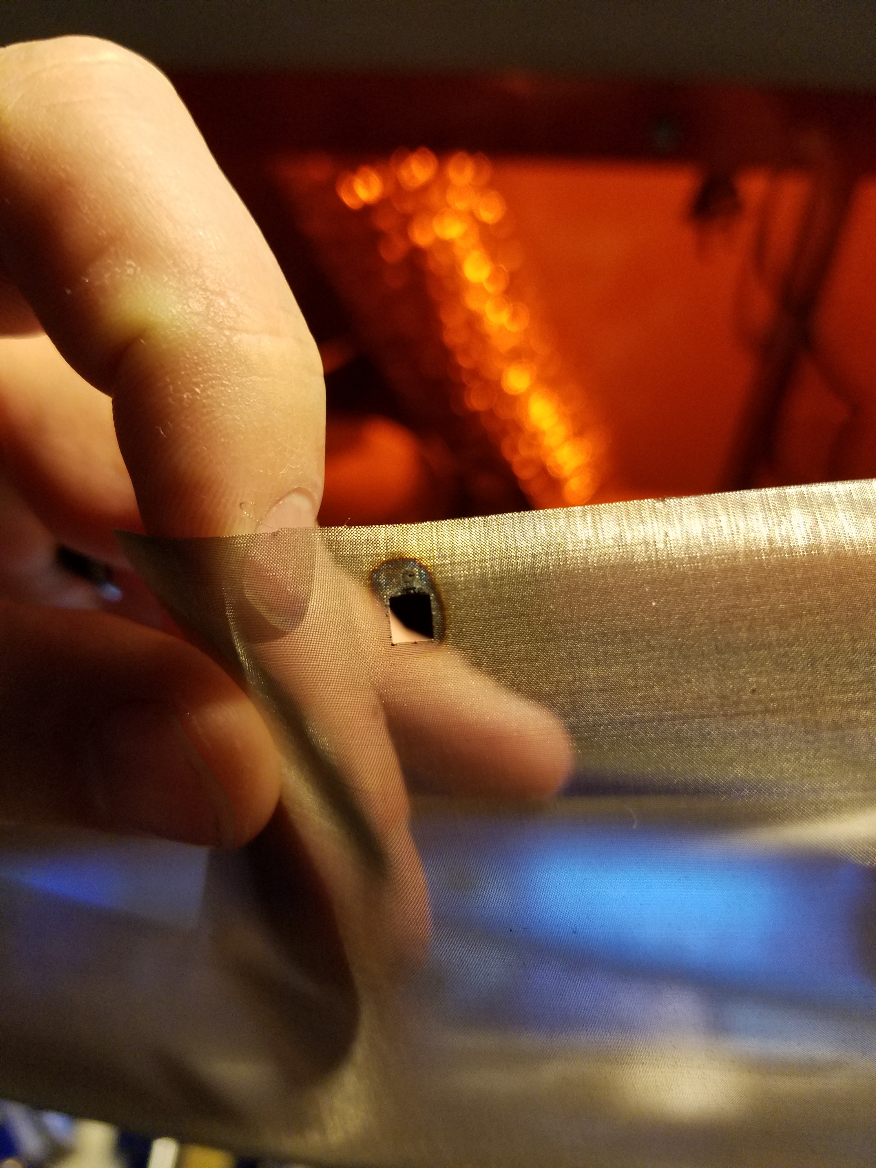

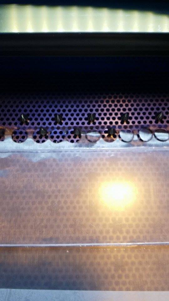

Like butter >.> first test I think was too hot lol.
Got it tuned in, if anyone was wonder, the k40 can cut ss mesh very easily.
Yep i got it. :smiley:
Awesome. Seeing is believing. Good to know for the future.

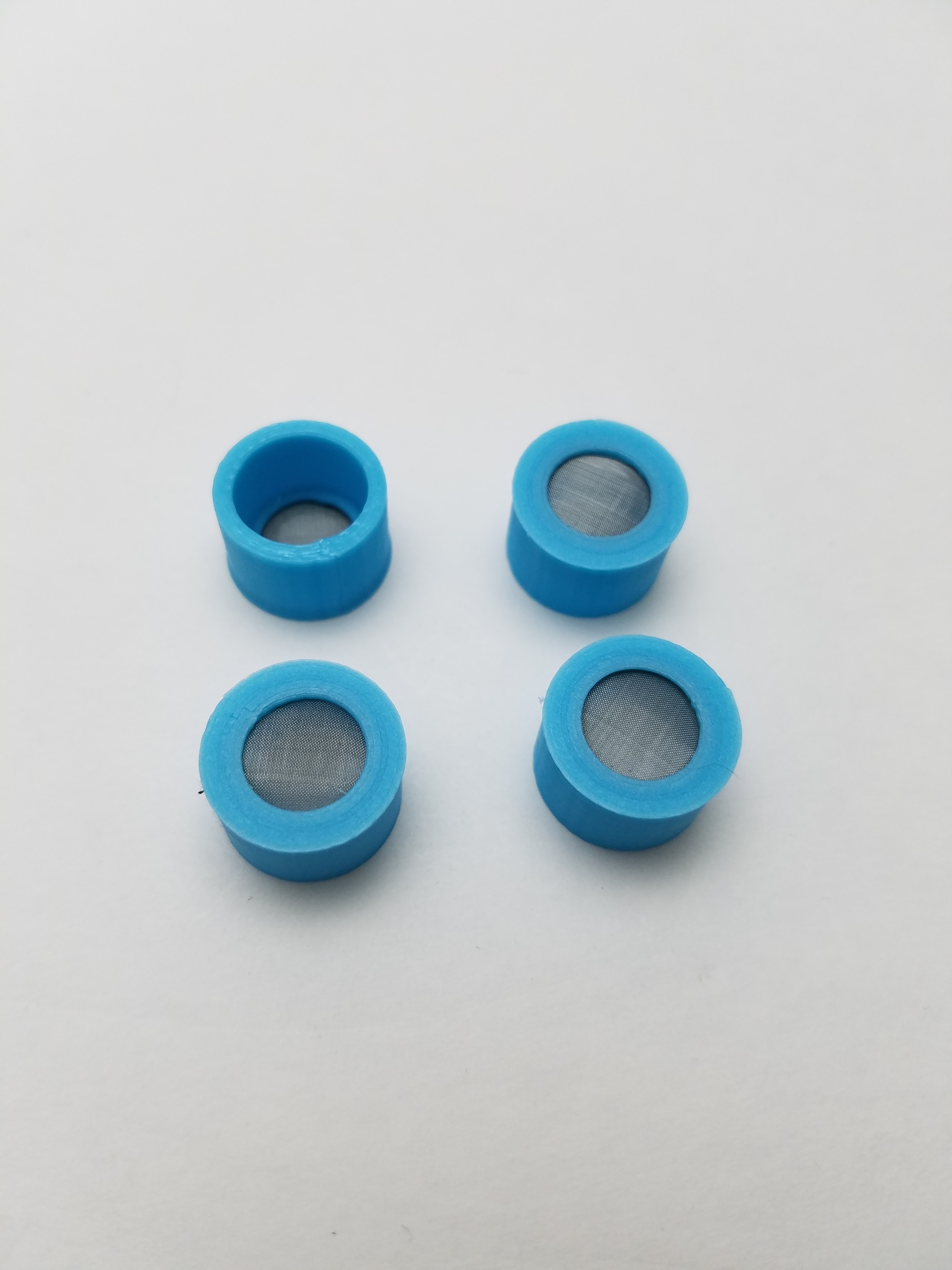

@Nedman lol Ned, I gave that up years ago. These are for tube caps for ant keeping projects I have. :slight_smile:
