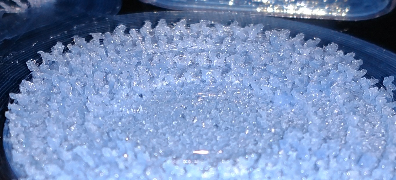

Anyone happen to know why this happens?
Anyone happen to know why this happens? Usually my prints start out fine and then a little ways through it just starts leaving blobs everywhere. I did have to turn my flow rate down though because my filament kept skipping if it’s any higher than 70%. Could that somehow be the issue?
Heat creep. Your hot end is allowing too much heat to build up further and further up. Cool off the upper portion of your hot end. You could also try printing a little cooler, or (I looked at some of your past posts) maybe putting some thermal paste between the heat break and the heat sink? Higher flow fan? Generally this is the cause of time-based extrusion issues.

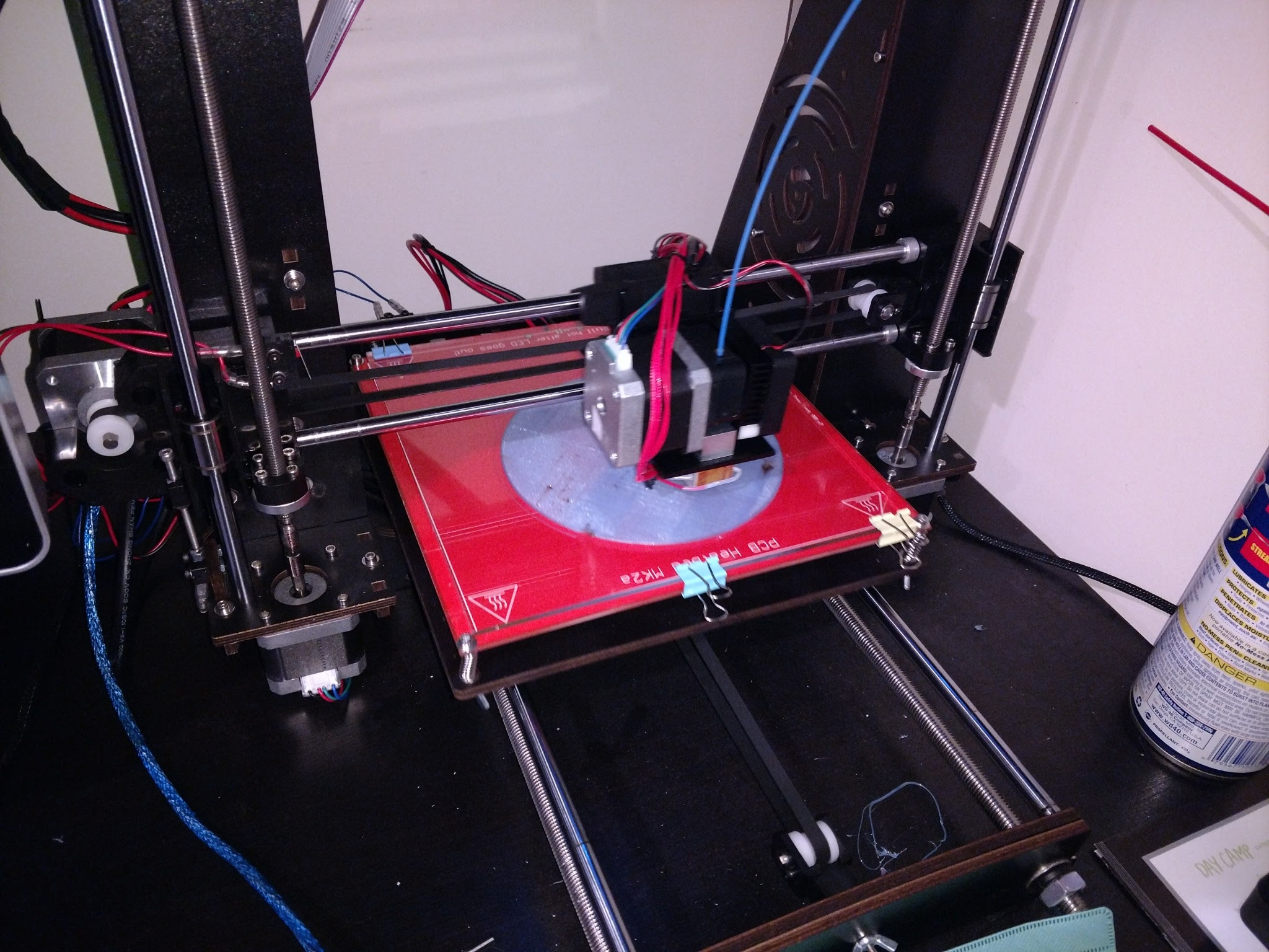

@ThantiK @Griffin_Paquette ​ so here’s the weirdest thing… I started printing this and the first layer was a little rough but I was tweaking some settings while it was running so I could visually see what was happening. I upped the temp to 210, the flow to 100% and the speed to 135% and now it’s working. The extruder isn’t making that “thud” noise anymore and it’s actually flipping printing! Slowly but surely as it prints additional layers it’s filling in the problems of the first layer and it’s not looking too bad! I’m going to let this run if it keeps going like this and see what happens. But if all is good, I may have finally found some usable settings. Fingers crossed!
@Kevin_Danger_Powers , the thing is - cold filament also acts as a heatsink in its own right. The heater has to dump heat into the material in order to get it soft enough to print. You might actually be solving the problem by simply sucking away enough heat by going faster.

I second @ThantiK ​ . Moving slower to fix extrusion problems is not always improving things. As an extreme, filaments like CFPLA (black PLA with small carbon fibers) conducts heat so well that I originally failed with speeds below 60mm/s (usually 75 mm/s and never an issue, which is quite nice). When the filaments start melting “too high” in the heating block, viscosity increases significantly which impedes the flow, until the hobbed bolt starts to slip and you get under extrusion.

@JuicyMoose_Productio I don’t think tension is the issue. The more questions I ask and the more things I try, I’m really starting to lean towards the heat creep that some people have mentioned. Pressing the filament into the extruder doesn’t help at all. I think it’s really just the shitty cooling design allowing the heat to get up too high.
@Kevin_Danger_Powers yeah then that does sound like heat creep. I go based off of common issues so I apologize for that. Have you made sure the fins are facing the correct side for the heat sink that’s practically sandwiched in the extruder?
@JuicyMoose_Productio yes, I have it facing the right way. If I flipped it around it wouldn’t fit back together. I do appreciate any info though. I’m still a noob to 3D printing so really anything could be an issue. So far I have worked out most of the bugs except for the heat creep and tweaking a few settings here and there. Things like thicknesses and speeds probably need to be tweaked a bit. I just learned about supports and filling in blank spots the other day.
