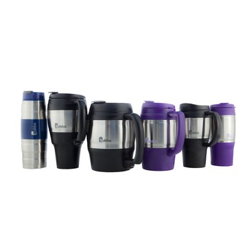

Anyone has experience engraving these with a K40? Is the cover SS or Alum? Is it imperative to use moly or Cermark? I may score a very big gig with the distributor to personalized them as corporate presents
what’s the name brand?
Bubba
I tried calling their customer service number but they are closed till tomorrow… I’m pretty sure they are stainless steel
The item descriptions on their website say stainless steel.
Try and drill a hole,if you can au
If they’re what’s available here (U.S.) they’re stainless steel and you’ll need dry moly lube spray (or Cer/Thermark).
Remember that the consistency of the mark depends on the consistency of the spay applied.
