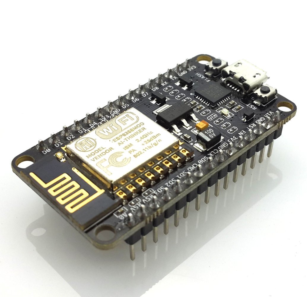

@Greg_Copeland looks like I ordered the right stuff. Might be over kill, but the ESP-12E Modules I also got are ESP8266 NodeMCU LUA CP2102 ESP-12E Internet WIFI Development Board (https://www.amazon.com/gp/product/B010O1G1ES/)
So now to send data packs between the two with FastLed is my next goal in life.
