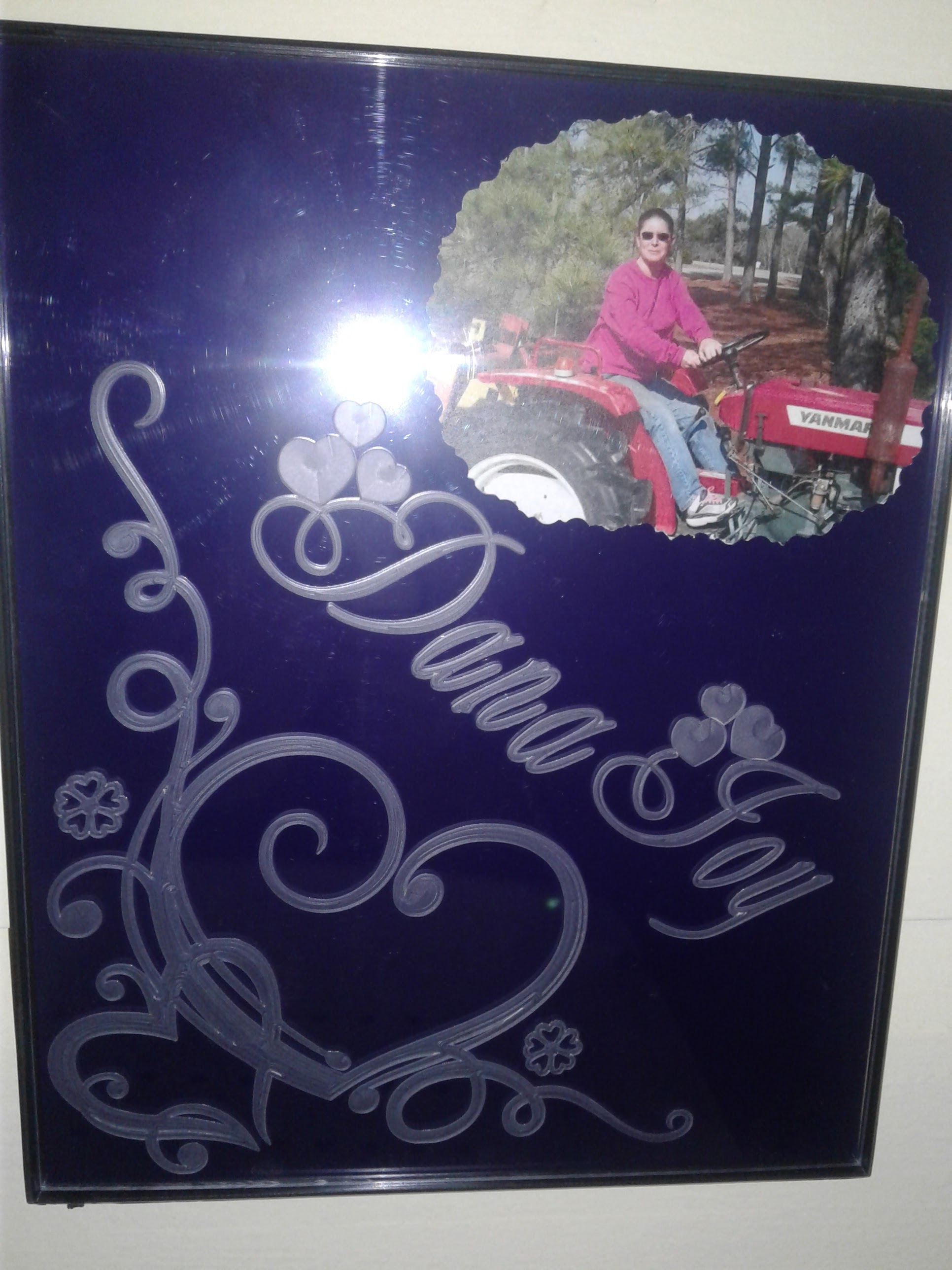

@Edward_Bigham great looking product, rare to see a Yanmar outside a boat down here.
@Jamie_Wilson I do it with a ball nose too. 2mm on aluminum 700mm/m .075mm DOC. 5mm/m dive.
@Brandon_Satterfield that was my firsttractor. My big tractor is an Allis Chalmers. It’s a 1968 one seventy. Older than me.
@Edward_Bigham That looks great!
@Colin_Kaminski thank you sir. I try my best. I just love experimenting with the r7.
