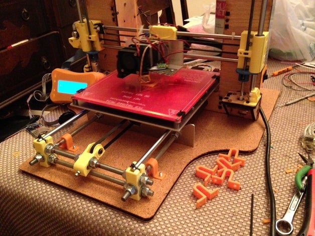

Anyone have stabilized their i3 rework or even yet just boxed it?
Anyone have stabilized their i3 rework or even yet just boxed it? Trying to eliminate some shaking.
I made a base and secured the printer to it. Added cork and also supported and secured the lower threaded rods a little more.
Quality improve? I need to find if I can get some rear support. As of now not sure how I’d attach. I’ll upload photo later and you’ll see what I mean.
