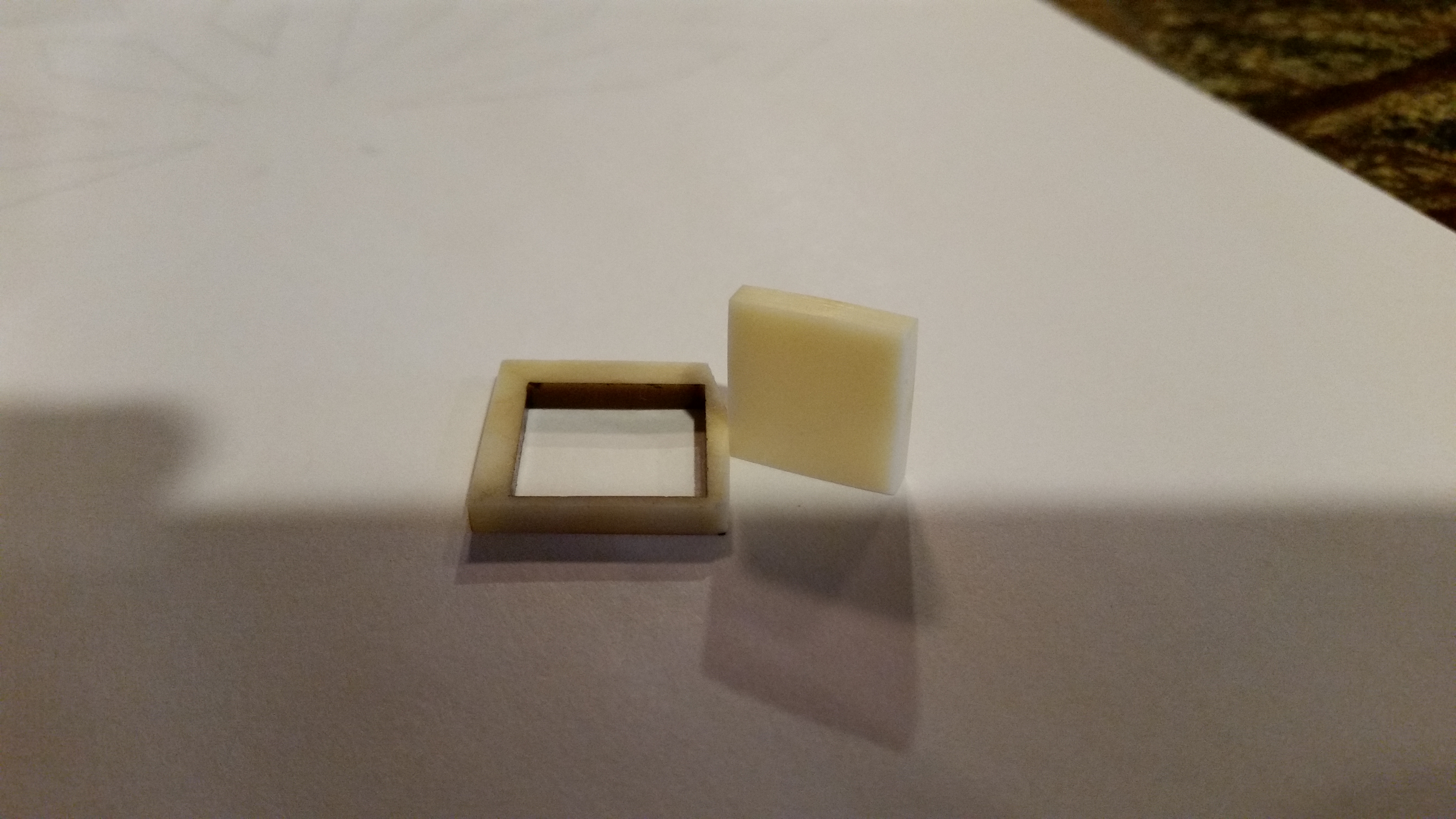

Picture? :slight_smile:
That’s cool. Gives me some ideas :slight_smile: I second Don’s request, would love to see how it lasers. Thanks for sharing.
Here is a picture of a test piece. That’s all I have left here right now. It is the first square test piece I cut out. the size is small about 3 mm thick x 18 mm. The edges clean up fast with 220 sand paper as the kerf burn is not very deep.
