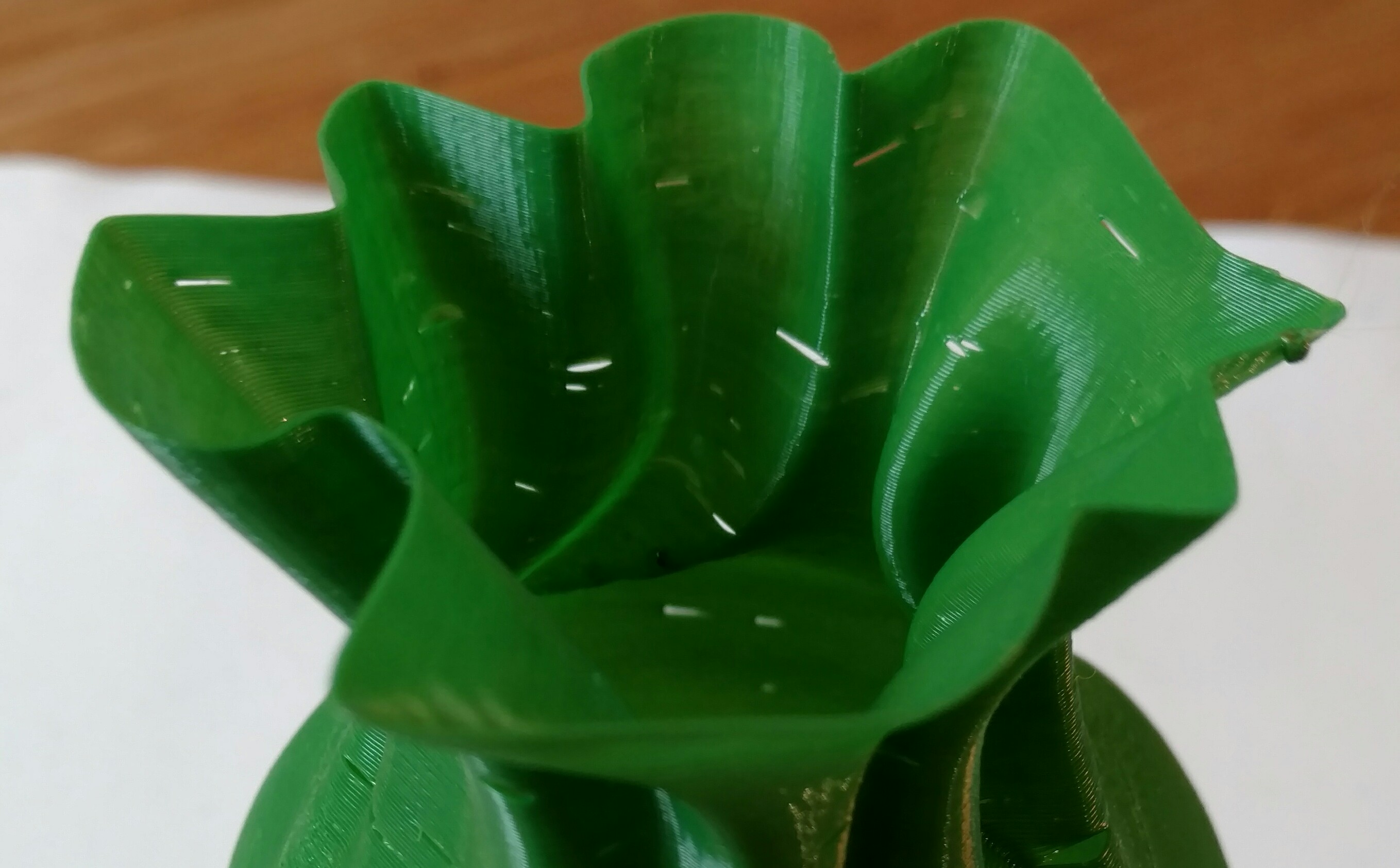

Anyone interested in Repetier-Firmware for CTC dual and other clones?
This is my first test print. (Very bad ABS with bubbles - did not expect to have results on first try)
