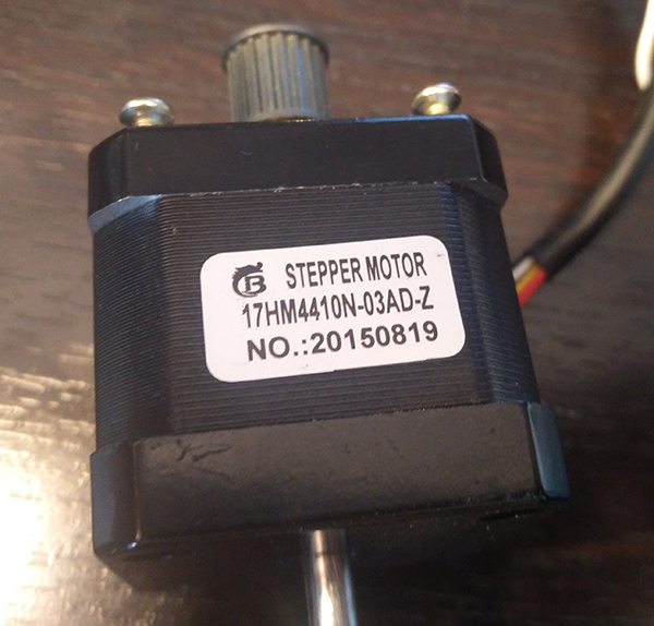

Anyone know a good replacement for the 17M4410N motor? Mine is dead and there is no solid info to be found all over the internet. And I would know cause I searched every last corner of it.

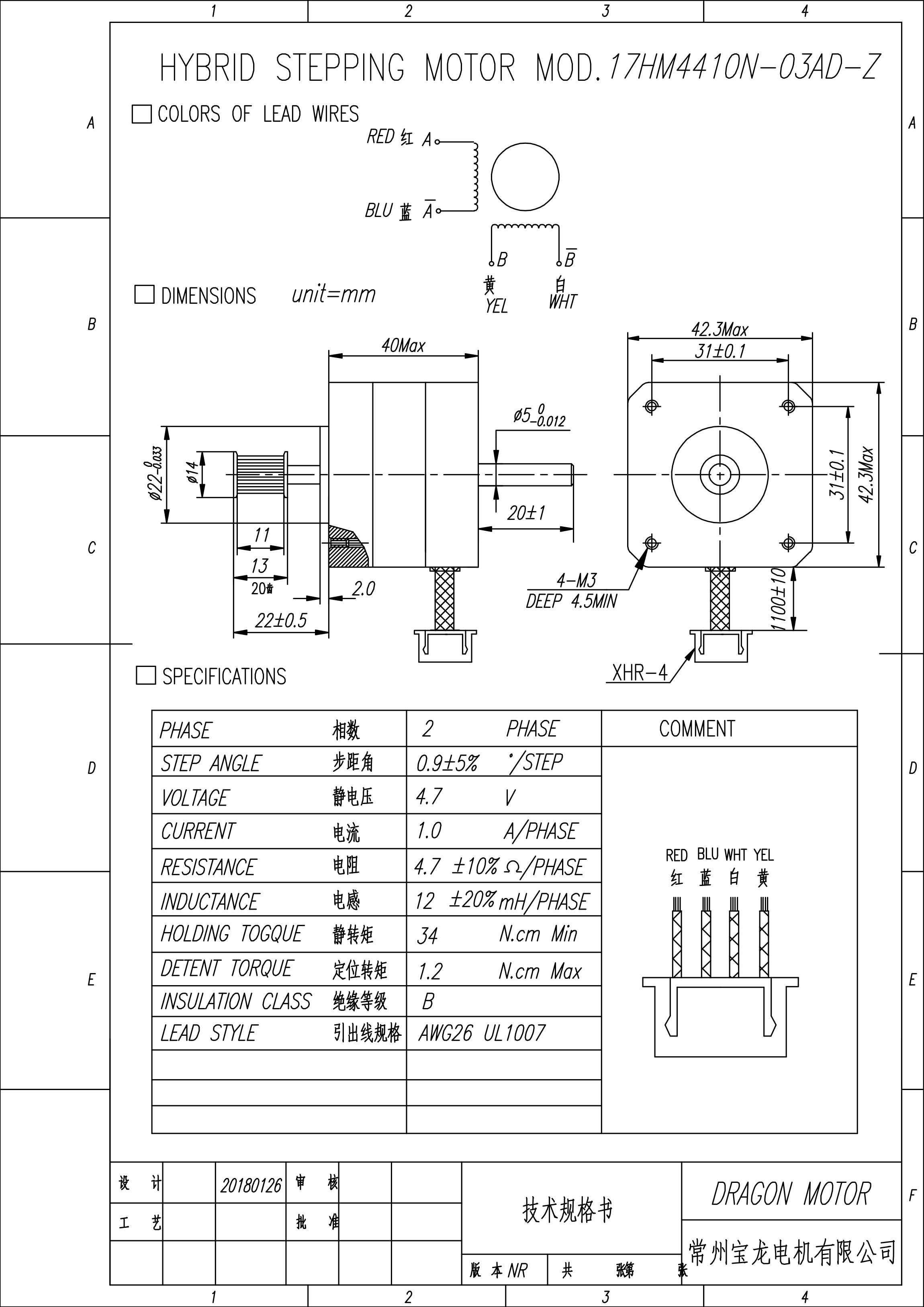

@Alex_Krause Yeah I found that post. But it conflicts with other sources. Specifically I need the step angle and rated current of that motor. So odd there is very little info about it, and I haven’t found a solid lead from someone who succesfully changed theirs.

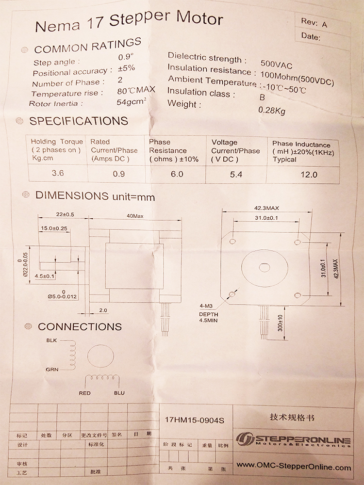

@Alex_Krause I have done some digging and found the original manufacturer of the motor. Long story short that exact model isn’t available anymore but from their naming scheme it seems this was either a 0.9deg 1A or 1.7A(!) motor. Doesn’t make sense but hey, nothing about that unit does. I bought a 0.9A to be on the safer side. We’ll see how it performs.

great thx! I’m currently talking to the company. They seem to be helpful, but communication is not optimal ;-). This is my motor. The logo helped me find the manufacturer. http://en.baolongmotor.com

I bought this one: https://www.ebay.com/itm/DE-Ship-0-9deg-Nema-17-Stepper-Motor-Bipolar-0-9A-36Ncm-42x42x39mm-4-wires-DIY/231657793068
Note that it is not dual shaft! For a direct K40 replacement you’d need a dual shaft.
I haven’t tried it though. So I’m not even sure it works. But specs seem close enough.
0.9A is a lot, hopefully your PSU will survive, how far do you test it ?
(normal K40 motor is 0.5A)
My original motor was 1A. I posted the spec sheet earlier in this conversation. I searched and contacted the original manufacturer of the motor bc there was a LOT of conflicting info on the step angle and current rating of the motors. Maybe other K40 versions got other motors. Idk
