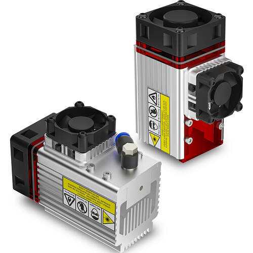

Anyone know the NEJE A40460?
Hi
I have heard of this laser:
It seems that it can engrave on stainless steel:
Stainless steel direct grayscale engraving: Yes
3D hardwood engraving: Yes
Maximum cutting thickness: 20mm
They say the wavelength is 450nm, which make it a visible blue - violet light.
Does anyone have some feedback about its capacities? Thank you.

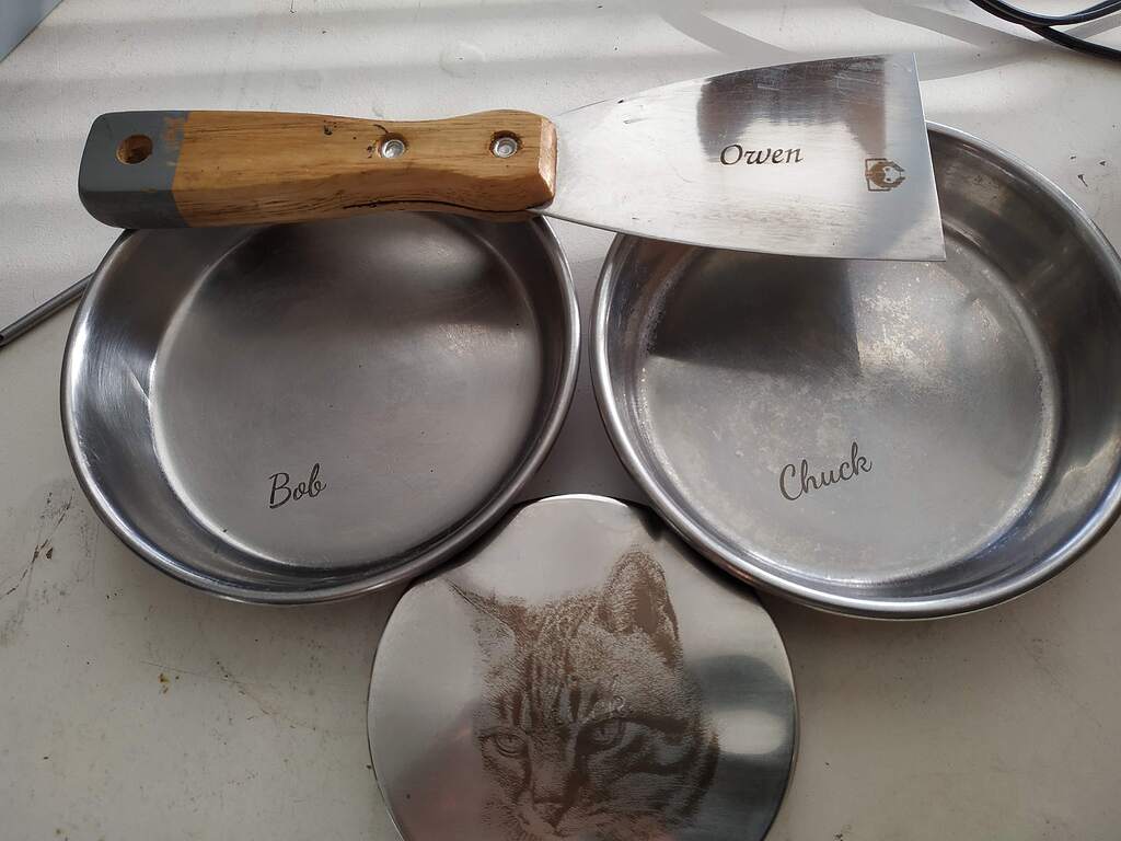

I’ve seen one person on here who’s marked stainless with a diode…
This laser module can engrave on stainless steel for sure. In order to get better engraving performence, working at 30mm is better, shorter focus lenght means smaller beam size, then you can get higher power desity to engrave esily; For cutting job, working at 55mm is better, longer beam angle is helpful for cutting thicker materials.

Tengo un laser NEJE 3 max , con el modulo de doble diodo A40460. Estoy bastante satisfecho con sus posibilidades, efectivamente es capaz de grabar metal, aunque con dificultades, hay que hacerlo correr muy lentamente. Yo, habitualmente trabajo el cuero, lo grabo y corto utilizando el software de control Lighburn. La versión Neje 2 máx. tiene algunos problemas, en la versión Neje3 máx. funciona mejor.
