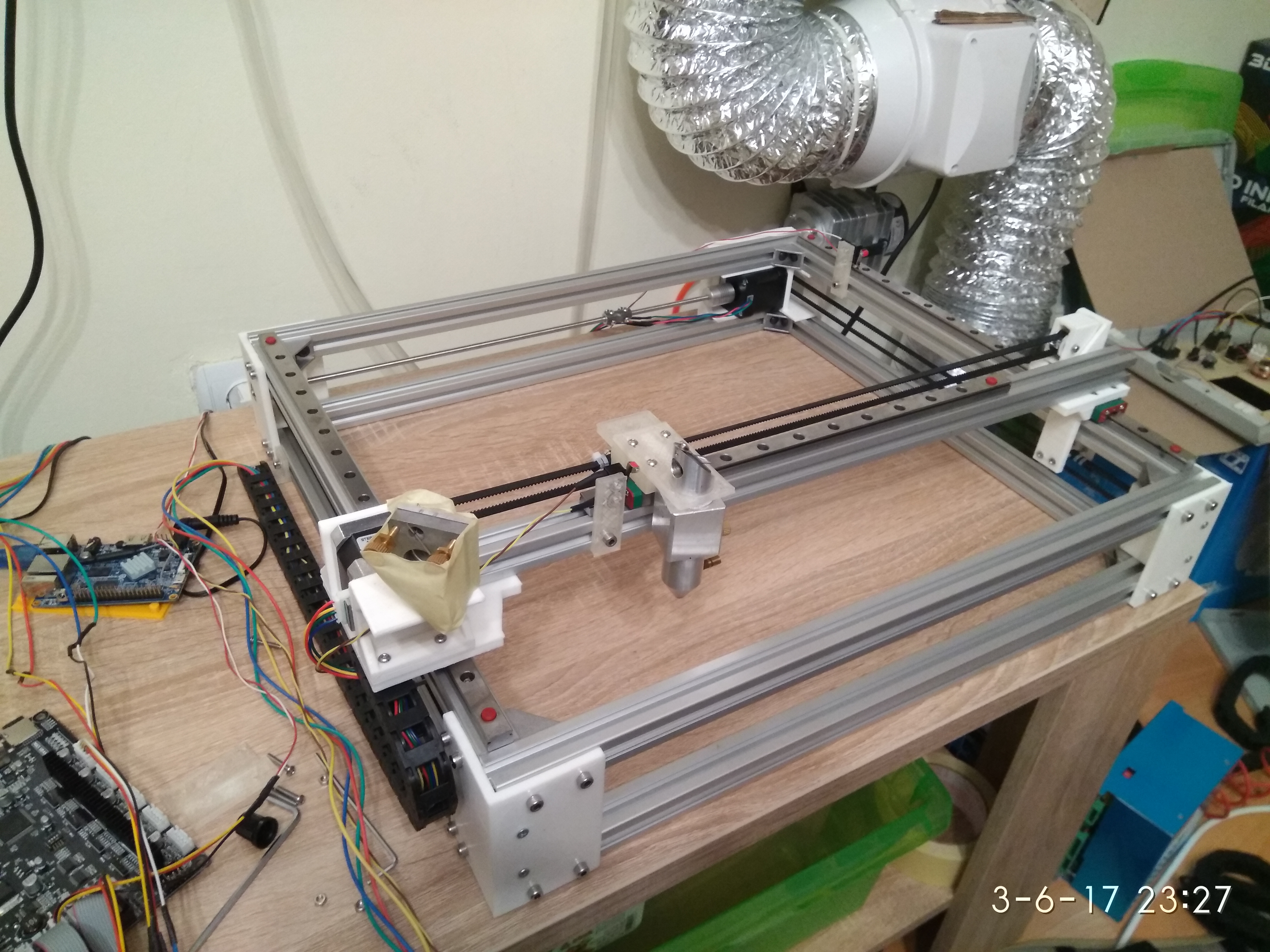

Originally shared by Mircea Russu
Can you type 0.001mm into the line width box? Might have to adjust the preferences for CorelDraw in relation to how many decimal points of precision to use.
Aside from that, I wonder what your Cutting Data & Engraving Data settings are for CorelLaser plugin? I had both mine set to WMF & was able to use 0.1mm line width & only get a single cut without it ever failing. Can’t test anymore though since I’ve upgraded controller.
Make sure that they are set as curves not text. Look in the “objects” menu for ‘Convert to Curves’. Make sure that ‘Join Curves’ is checked as well.
where can i find more information on this “mod” ??
