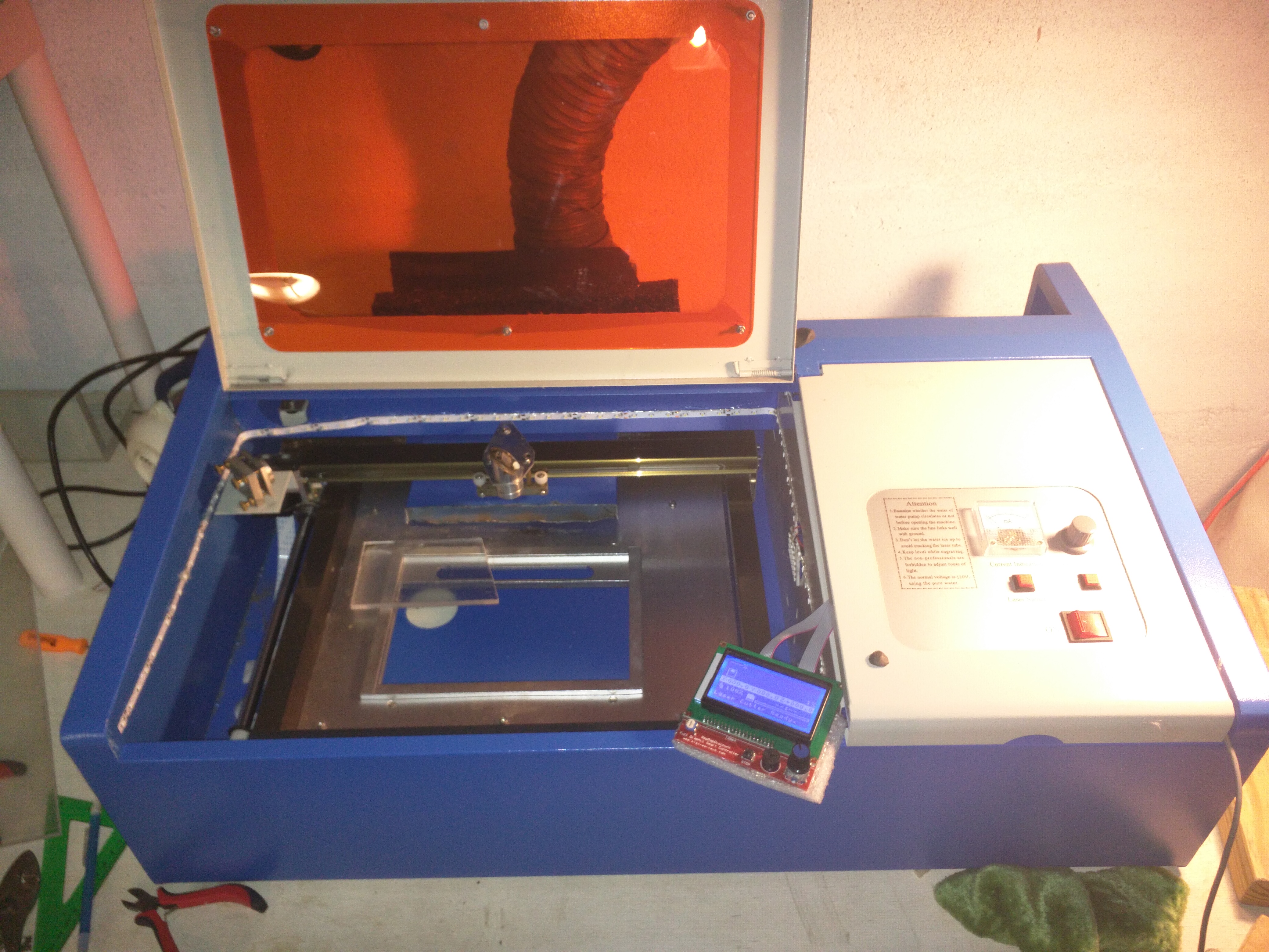

Anyone know what codes turn laser on and off?
Anyone know what codes turn laser on and off? I found a pic software to use but requires codes for laser on and off. After going back and forth with the guy, he’s asked about possibly wiring laser to d9 to generate faster speeds for photos engraved, anyone familiar with this ?
I’m thinking perhaps connecting a lower power laser diode to the existing spindle to offer a choice when printing a job. Any thoughts on this?
Looks like you have Marlined it or Ramped it so it’s M3 on and M5 to turn off

If you need some help, @Andrew_ONeal_Andy-dr , you should describe a bit better your situation, hardware, software, d9 ?
a laser diode is an idea we had, making is way slowly …
What do I gain with smoothie and what do they run? Just seems like the laser diodes do better and at such low power in comparison to this k40 co2.
@ChiRag_Chaudhari thanks for the codes man. Yes it’s ramps, but have had so many issues with the gcode generation for projects. Tried many encoder plugins but the one software that’s most promising is pic engraver and or jtech photonics both require laser on and off codes. I’ve learned a ton in researching all this and now think I’ve got a handle on the coding. Still I have yet to even print a single job, aside from a test line burnt into wood. Thanks again for all the support.

@Andrew_ONeal_Andy-dr ​ I did try jtech plugin too but nothing works better than Turnkey with LaserWeb for me.
Heyyyyy my 3.8 diode is as mini John cooper work
@ChiRag_Chaudhari ​ does turnkey run on a rumba?
Not sure. I have to Google what’s this Rumba is first. LOL. I’m guessing it’s another control board.
A Rumba is just an Arduino MEGA with a custom PCB layout that’s meant to run a 3D printer. Anything that will run on RAMPS, Azteeg, etc will run on the Rumba. The Rumba can run Marlin, which TurnKey was meant to target, so the answer is yes. It’ll run on a Rumba.
@ThantiK if you are going to quote someone then include the entire statement. “Just seems like the laser diodes do better and at such low power in comparison to this k40 co2.” This is all very new to me which is why I turn to those who know more than I do. Right now I have a k40 laser that I rebuilt regarding electronics and is fully functional but I’ve yet to use it for anything, other than a straight line test.
@ChiRag_Chaudhari that’s awesome. Just haven’t had time to mess with it here lately. I got really hung up on how to ready a image or cut in inkskape with out with out using plugins. Laserweb is that like pronterface?
