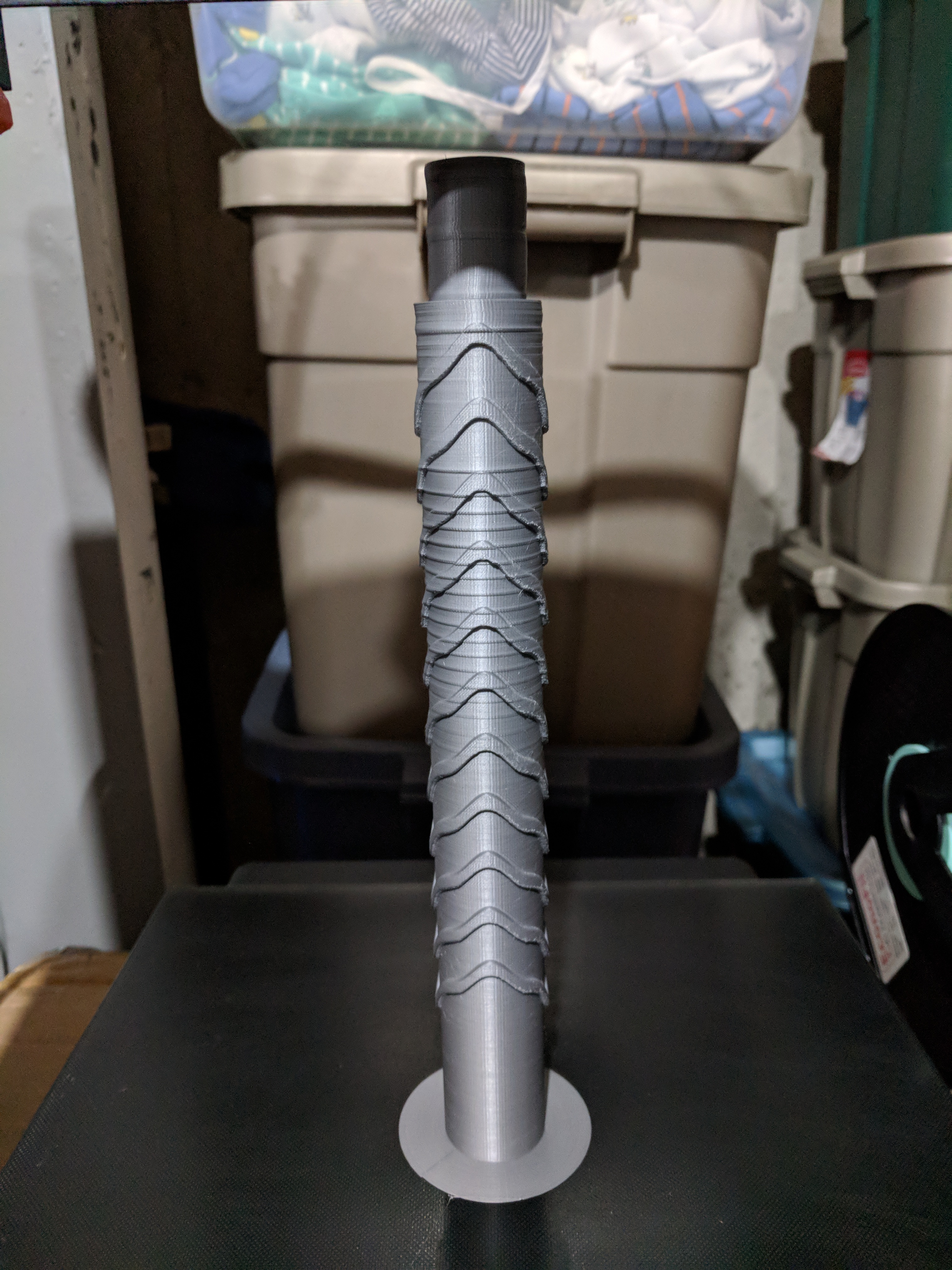

Anyone know what could be causing this issue, first half seems perfect,
Anyone know what could be causing this issue, first half seems perfect, but as it gets higher there are layer shifts, only slight ones, and they seem at least for a specific area to be happening like every 5 mm or so.

Rotate your Z screw by hand to see if it’s wobbling…

Not printer wobble, screw wobble. Like the screw is bent… and when the X bridge reaches a certain height the screw is pushing on the gantry bearings and flexing the Z rod. Common cause of evenly-spaced ripples/ridges in prints.

How are you feeding plastic from the spool? Could be a filament tension issue. Other than that, I would look at the attachment between the print and the machine. It doesn’t look like an axis shifting, more like the print and/or print head is being periodically pulled out of place.
Vibration during x,y motion. The higher the thingy the more it wobbles. Try reducing printing speed.
Or better print it horizontally.
I’ve had something like that and it was a spool of filament that was not wound very well. The filament would keep getting stuck every so often then suddenly free up.

I agree with @Ivan_Volosyuk as the model gets higher, I think the model itself is shaking. Try horizontally.
To verify this, you could try printing something with a sturdy base like a pyramid and seeing if that z-variation is at the same point
