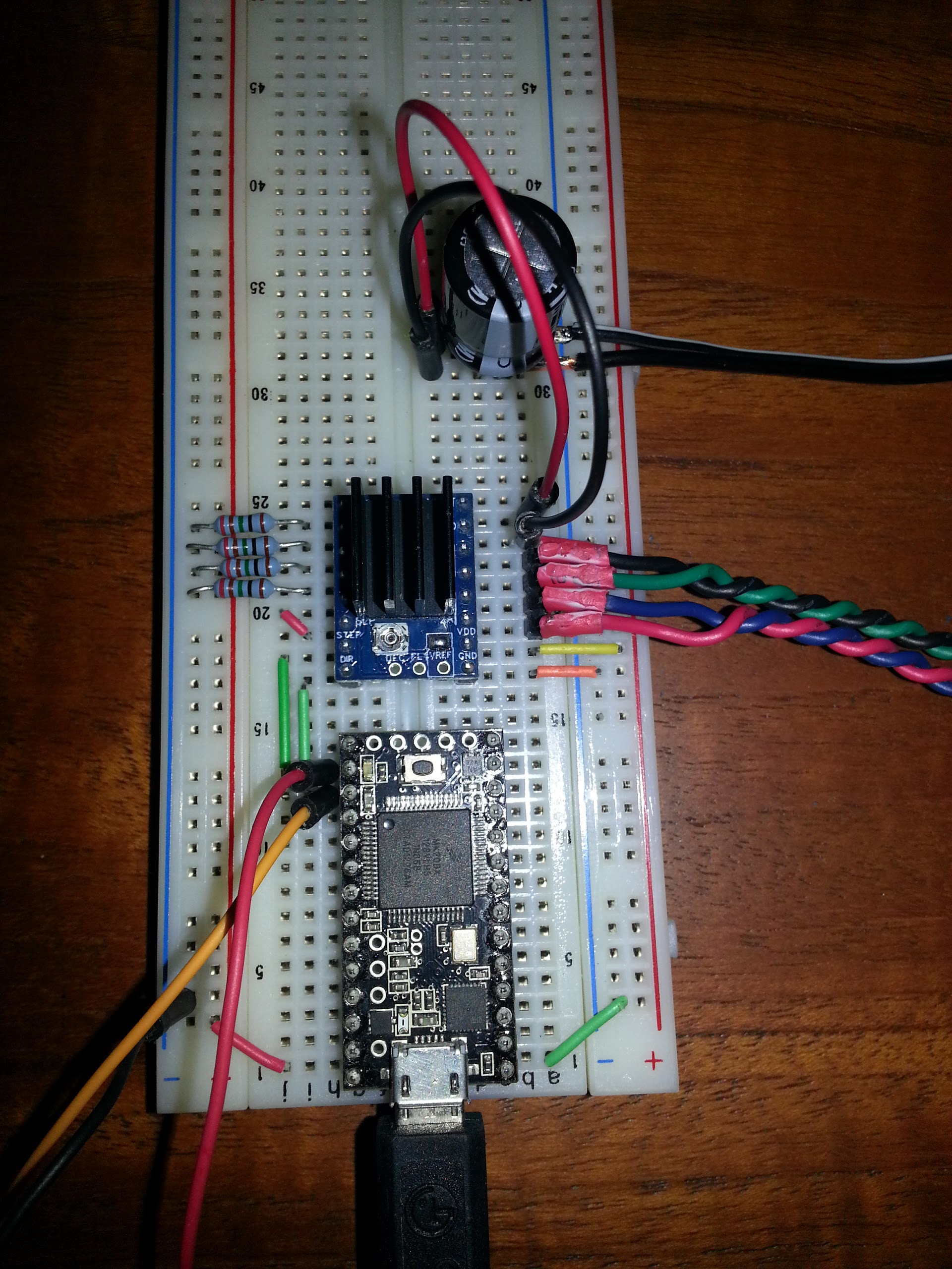

Originally shared by Robert Wozniak
Having fun tonight with stepper motors.
I’m driving a NEMA17 Stepper motor with a Panucatt SureStepr SD8825 Stepper Driver all from a Teensy 3.0 running at 96 Mhz.
Running AccelStepper Library. I’m playing with all the parameters, but have been able to reach 3000 RPM.

These are my current settings:
Frequency: 10,000 steps/sec
Acceleration 750 steps/sec/sec
Pulse width 13 uSec
Current limit 650ma (power supply)
Drive voltage 18V

Hey man what kinda circuit board is that? I have been searching for one similar.

@Johnathan_Breaux It’s called a solderless breadboard. There are lots of sources on the web for them
