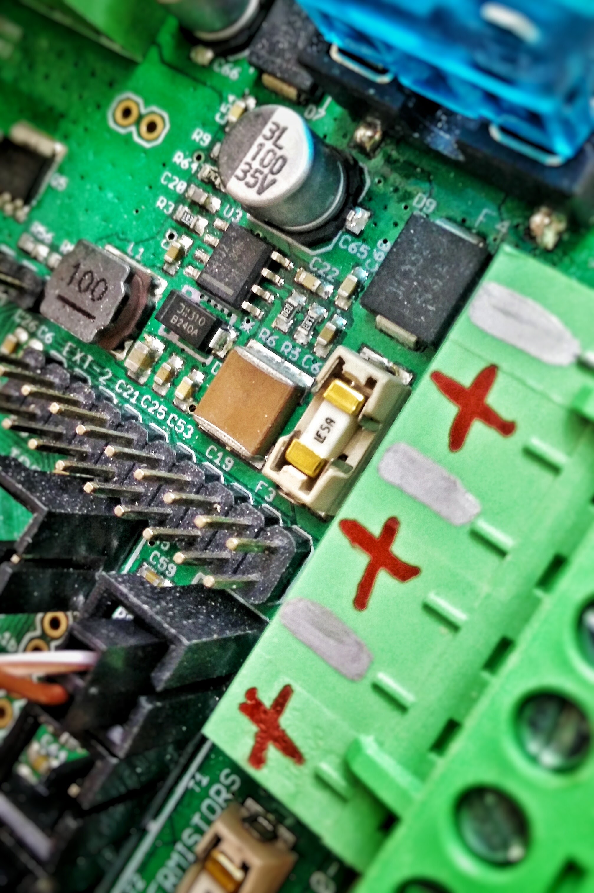

Anyone know where to find these Omni-Block NANO2 fuses (in Europe or from Asia),
Anyone know where to find these Omni-Block NANO2 fuses (in Europe or from Asia), as used on the RAMBo board? The only places that seem to carry them are Farnell (minimum order, shipping, …) or ebay sellers from the UK that charge almost 30€ for a set of 10.

@VolksTrieb unfortunately, they only carry a 4A version in the correct dimensions.
Now, i hadn’t realized these were just simple SMD fuses, originally intended for soldering - i always thought they were specifically made for the Omni-Block holders. Just searching for “SMD fuse” and then going by dimension sure widened up the range of what’s available.

@Thomas_Sanladerer I ordered some from aliexpress, search for " SMD Fuses 1808". I don’t know if they fit your socket but it locks similar. Size is 6.1x2.69mm. I got these: http://www.aliexpress.com/item/LF-genuine-original-SMD-Fuses-1808-10A-fuse-gold-pin-LF10A-disposable-CQWYJZ/32468762215.html?spm=2114.13010608.0.91.kjhbdX

@Daniel_F thanks for that - 1808 is exactly the denomination i was looking for!
