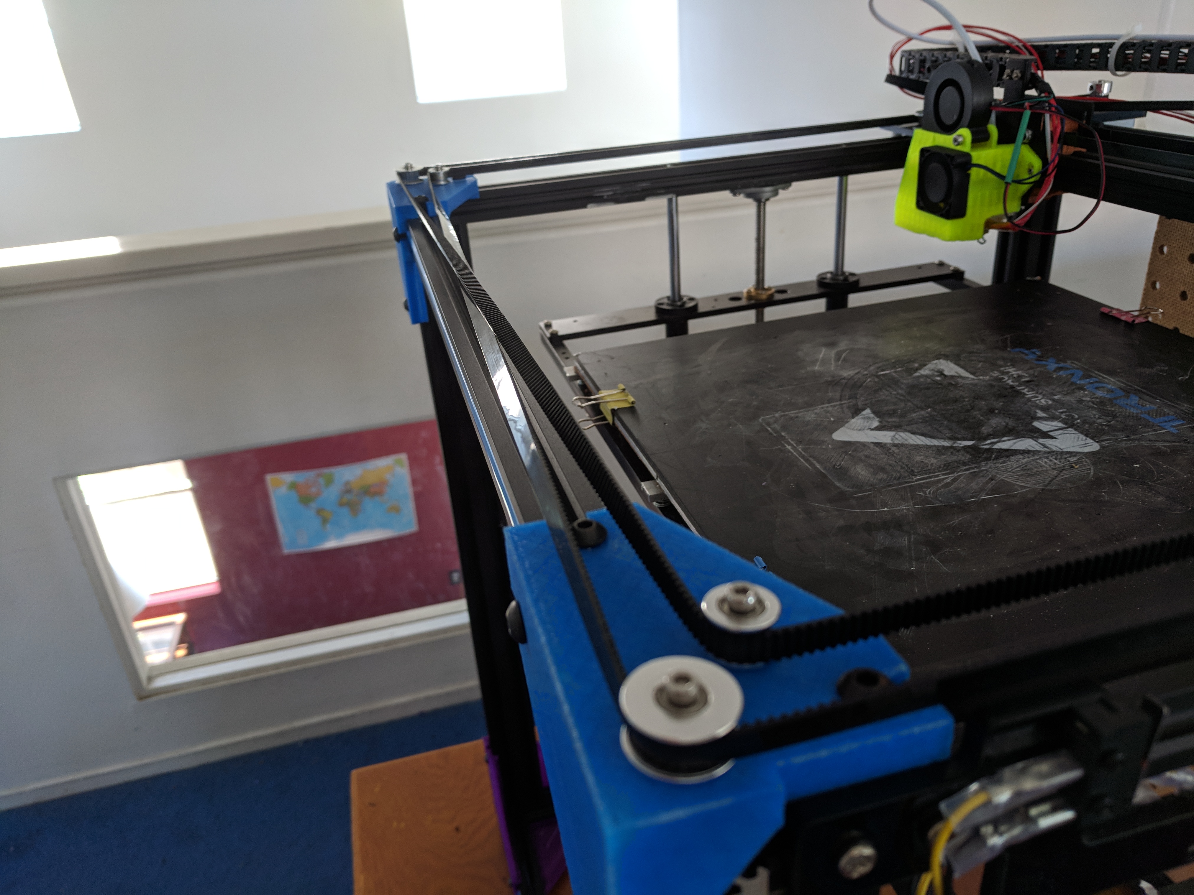

@Paul_Eberhart I have two CoreXY printers (one unfinished) that route the belts in single plane. Put a twist in the belts in front, so they cross w/o issue. As a result the assembly in of minimal height.
@Preston_Bannister Neat, I didn’t know that was an option. Looking at some examples, seems like you need a tiny bit of extra XY area on the gantry to get clearance around the pulleys, but that’s a nice topology.
@Paul_Eberhart No extra clearance needed. On the first build, I put a spacer between the belts. For this, just let the belts touch (to see how/if that would work). The force between the belts is tiny, and after hundreds of hours of printing … this is just not an issue.
Totally agree that belt rubbing is a non-issue. I’ve tried comparing crossed-rubbing and separate-plane belt routes on the same printer, and never noticed the slightest difference.
