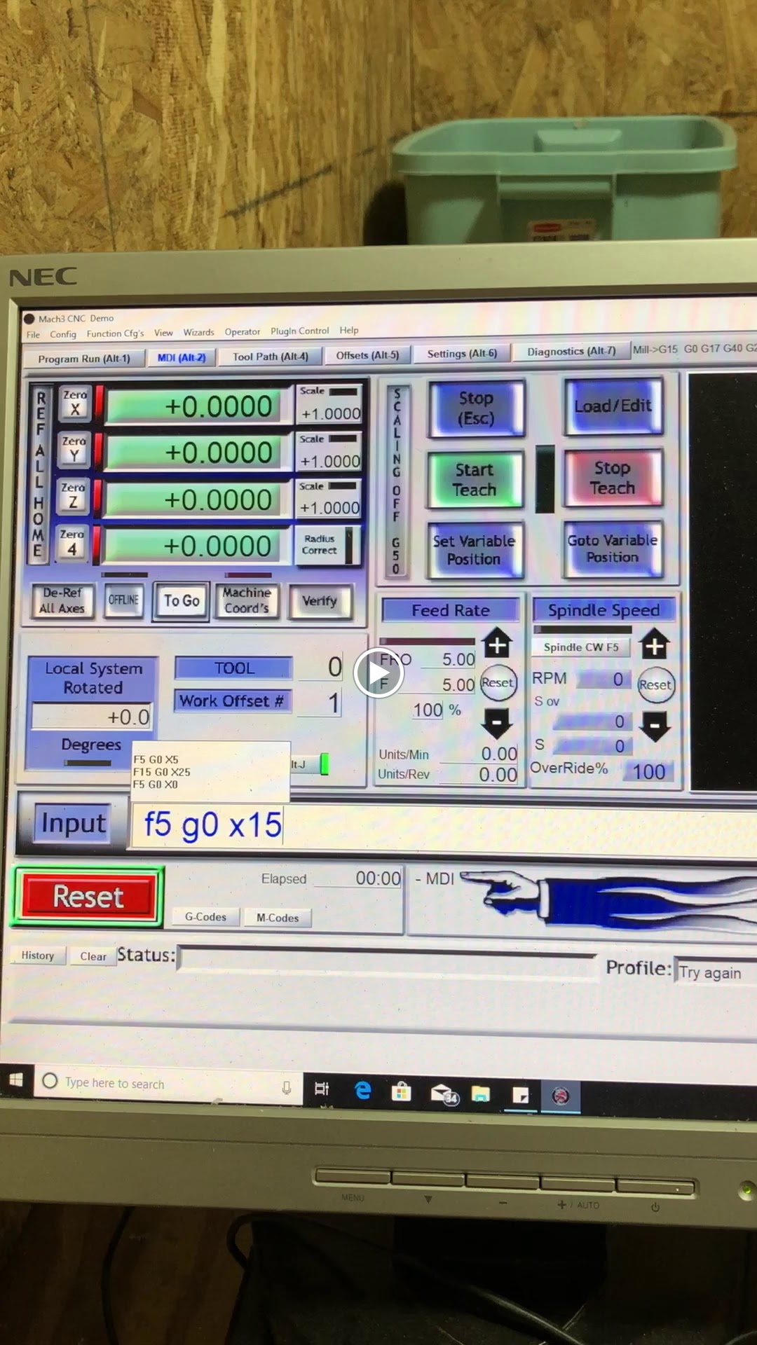

Anyone know why my motors would begin turning, but stop halfway through like this?
Looks like your doing a g0x15 move which will ignore the feedrate f5 parameter.
This will command your motor at it maximum feedrate setting. Either your acceleration or max feedrate is set too high.

g1 x15f5
@Jim_Fong ok. Is that also related to how I have the motor tuned? Do I need to change anything in settings if this is a 15:1 ratio planetary gear reducer?

@George_Allen with 24v supply, your not going to get very high motor rpm. With 15:1 reduction, I’ll be surprised if the output shaft is spinning more than 75rpm. You are running into motor rpm limits.

@Paul_Frederick yes, that was the problem. Once I lowered the velocity it worked fine. I may switch off the gear reduction if it causes problems. I thought the gear reduction would help get through harder materials.
