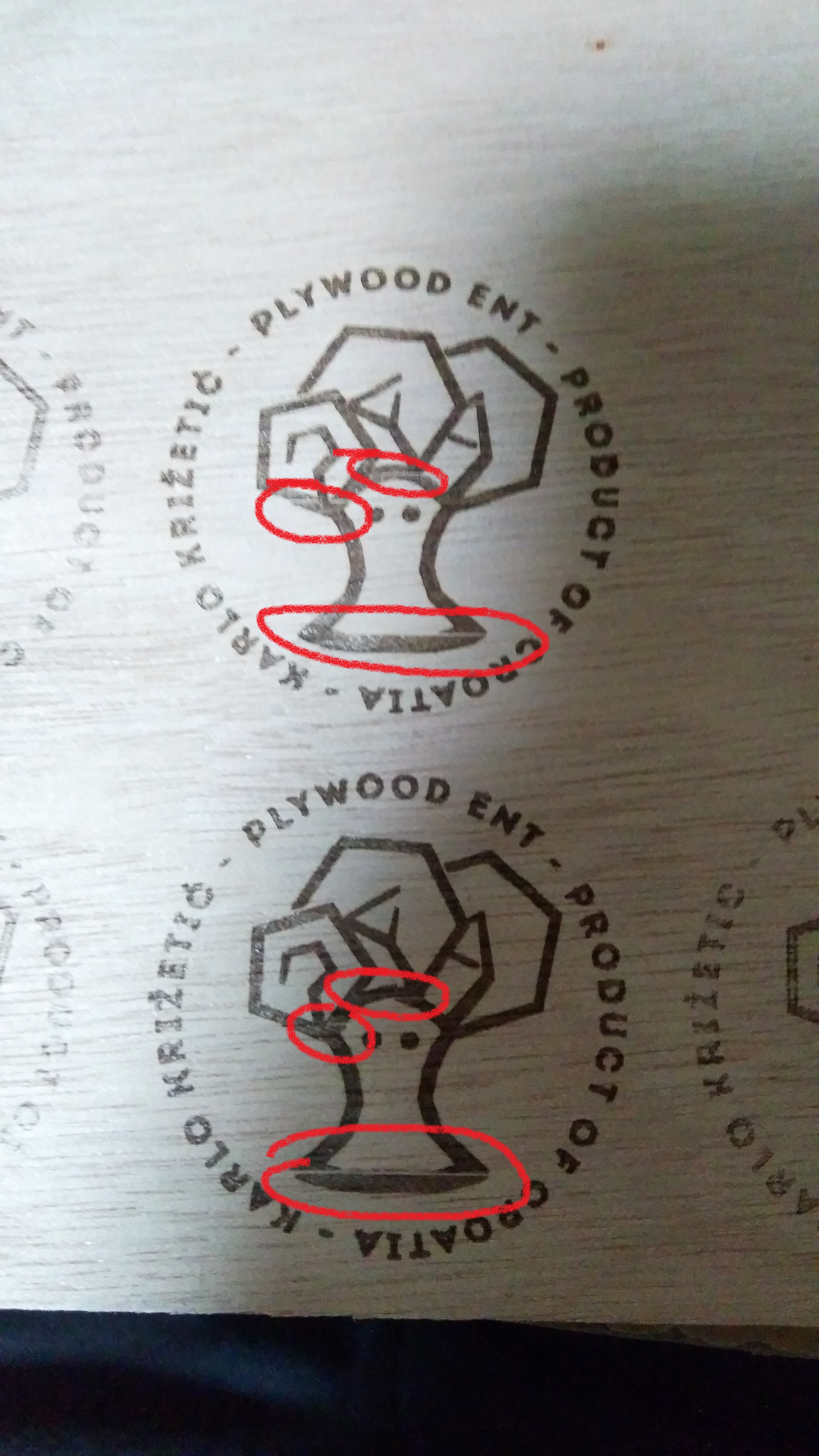

Anyone know why these lines are showing up? The image is solid in those places.
This happens when I use Laser Fill Path with a svg images, and the empty lines are always in the same place if I don’t change the parameters. So if for example I change the Line Distance a bit, those empty spots will appear in other places but always in those places with that Line Distance.

@Ariel_Yahni_UniKpty It’s really weird because for a particular set of setting the lines will always show up in the same places, if it wasn’t for that I would this it was a problem with my machine.
Is the above image 2 different tries?
@Ariel_Yahni_UniKpty Yes, I think that the one above was done at a bit higher speed. But the Line Distance was the same so the empty lines are in the same spots.
Im asking to know if this happens anywhere in your bed
@Ariel_Yahni_UniKpty I understand, I tried doing it in multiple spots all over my work area and I got the same results. I thought it was my machine at first but after I tested that I wasn’t so sure anymore.

I also just tried turning the stock 90 degrees and the lines and in the same places again.
I also tried changing the Line Angle from 0 to 30, 45, 90 and these empty lines always show up, just at a different angle now.

I can tell you this happens to me as well. It has something to do with how laserweb does the fill. By it skipping around to make the most optimized path it doesn’t always laser the area where it picks up again.
@Chuck_Comito I didn’t think of that before, but it does make a lot of sense. You haven’t found any way to make it’s filling path a bit dumber by any chance, have you?
Yes, just scan side to side. When I’m doing fills I’ve resorted to lightburn. Laserweb is still great for most things but I find lightburn better for scanning.
