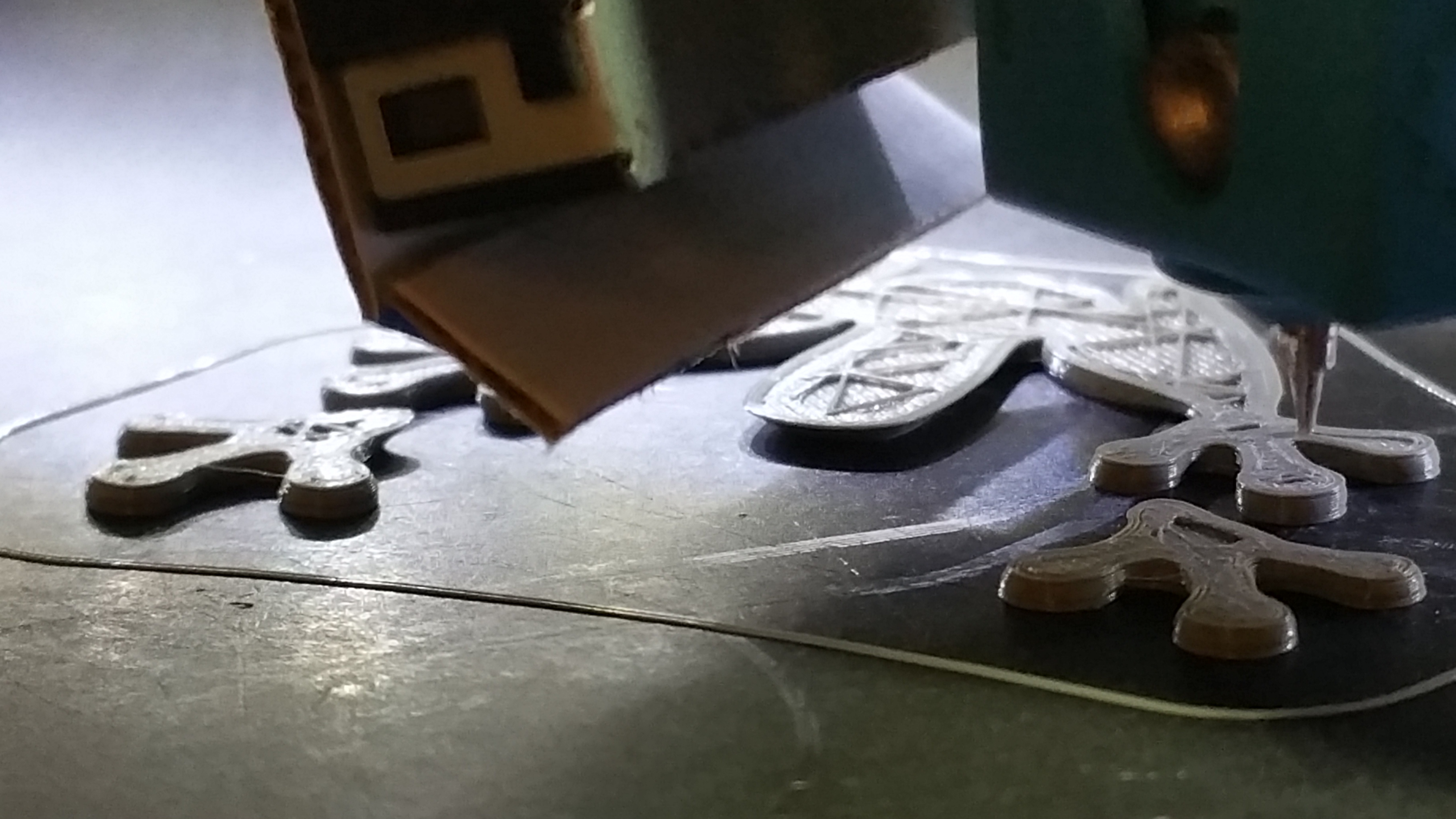

Anyone printed this tree frog before must be painfully aware that those two front
Anyone printed this tree frog before must be painfully aware that those two front legs are quite a challenge to complete due to its overhang angle. This airbrush pointy nozzle keep those overhang surface flat and nice.
Confirmed heat radiates due to close proximity to heatblock causes warping overhang no matter how good your cooling part fan.
Wait 'til you get the smaller heaterblocks :smiley:
The silicone socks from e3d also help greatly with shielding the part from the heat radiating from the heater block.
The silicone sock help a smidge. Don’t expect much it still curls up those fine overhang layer. @Sanjay_Mortimer ​ pointy nozzle please
