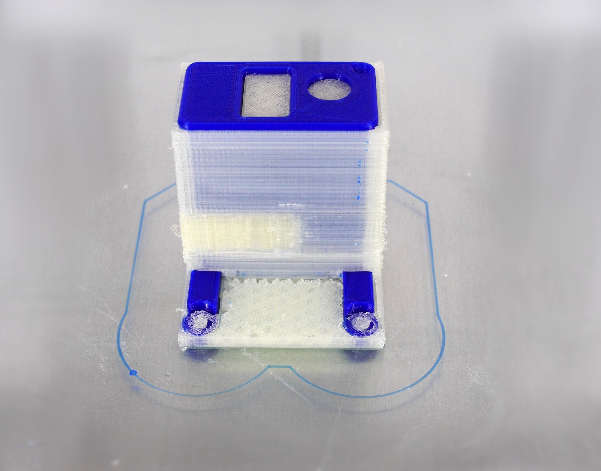

Cheap dual machines will never work reliable and clean enough. I’ve been printing some 150 hrs with dual extrusion and different types of materials now and get clean results without using priming towers or ooze shields. But for PVA I see few use cases where the benefits outweigh the nasty printing properties.
