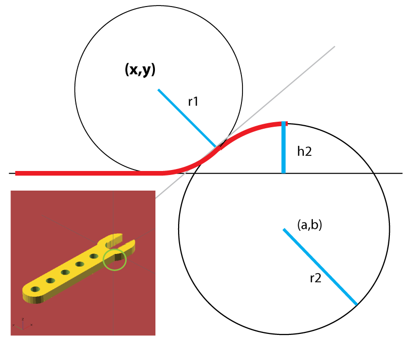

Anyone up for a little trigonometry on a Sunday? I like to make a fillet in OpenSCAD for the area in the image. Essentially I have broken it down into finding point x,y with the variables on the picture known.
Its not even trig. Some basic algebra will solve this.
I’m assuming a,b,r1,r2,and h2 are all known values.
Call your horizontal line the origin, so, y == r1
The distance between (x,y) and (a,b) is sqrt((x-a)^2 + (y-b)^2)
That distance is also equal to r1 + r2
so we can say:
r1 + r2 = sqrt((x-a)^2 + (y-b)^2)
now, x is the only unknown value in that equation so we throw some algebra at it and solve for x
square both sides and we get
(r1 + r2)^2 = (x-a)^2 + (y - b)^2
subtract (y-b)^2 from both sides
(r1 + r2)^2 - (y-b)^2 = (x-a)^2
take the square root of both sides:
sqrt((r1+r2)^2 - (y-b)^2) = (x-a)
add a to both sides
sqrt((r1+r2)^2 - (y-b)^2) + a = x
from earlier we know that y = r1
y=b-r2-r1+h2; (a-x)^2+(b-y)^2=(r1+r2)^2; x=a-sqrt((r1+r2)^2-(b-y)^2);
Thank you both. I was messing around with tangents. A bit late in my part of the world. Will check it out tomorrow.

Finally had time to wrap my head around this. Here is my final soultion.
/* Creates a fillet to a cylinder
r = fillet radius
h = z height
dy = fillet y edge above baseline
rc = cylinder radius
F = correction for floatingpoint error
module filletForCylinder(r,h,dy,rc,F=0.01, center=false, $fn=$fn) {
translate([0,0,center ? -h/2 : 0])
difference() {
translate([(cos(asin((dy+r) / (r+rc)))*rc)-F,dy-F,0])
cube([sqrt(pow(r + rc,2) - pow(dy+r,2))-(cos(asin((dy+r) / (r+rc)))*rc)+F,sqrt(pow(rc,2)-pow((cos(asin((dy+r) / (r+rc)))rc),2))-dy+F,h]);
translate([sqrt(pow(r + rc,2) - pow(dy+r,2)), r+dy, -F]) cylinder(r=r, h=h+2F);
%cylinder(r=20, h=10);
%translate([0,-10, 0]) cube([40,20,10]);
for(i=[0,1])
translate([0,0,5]) rotate([180*i, 0, 0]) filletForCylinder(r=14,h=10,dy=10,rc=20, center=true);
