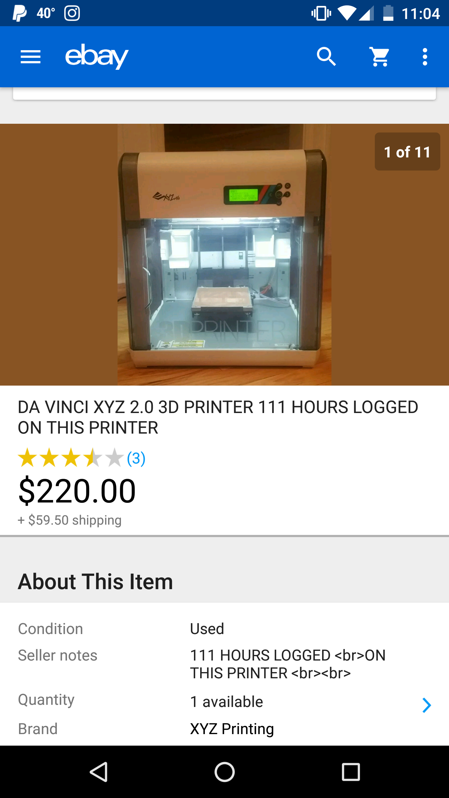

Anyone use a davinci 2.0 out there?
Anyone use a davinci 2.0 out there? I have a 1.0 that I have made into a workhorse with over 2000 hours on it and is flashed with repetier. Just bought the dual extruder version and hoping to do the same. Here comes printer #4!
